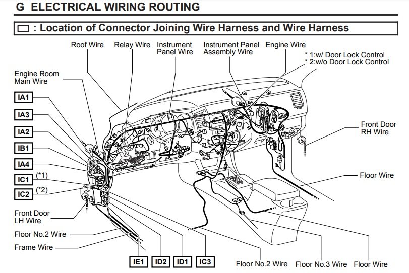

    I'm assuming it was the IB1 connector behind the drivers kick panel, it is a known point of bad connections to the fuel pump.

    That sounds like what he was talking about! I’ll have to peek up in there when I have time and see if that lines up with the wiring diagram.
    Thanks for the insight, I probably wouldn’t have known or even found out about that otherwise.

    It's not all that common but I have seen where some members have had bad fuel pump connections at the IB1 connector.
