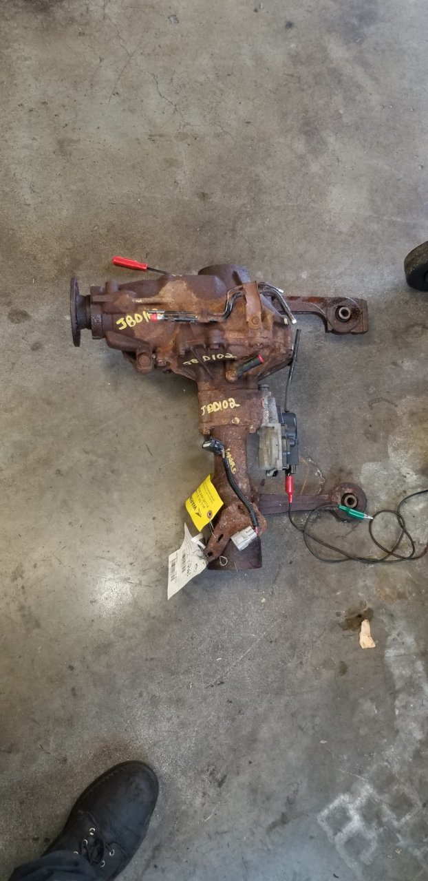

    I received my front diff last week and finally got around to unboxing it and checking it out. The outside of it is rusty and gross being it came from NY but seals look good and internals that are visible look perfect. Good gear lash and has newer bushings at all 3 mounting points! Also came with an ADD actuator and it is fully functional! Pretty good score. Paid $250 including shipping for the diff with all mounting brackets and ADD actuator included.
