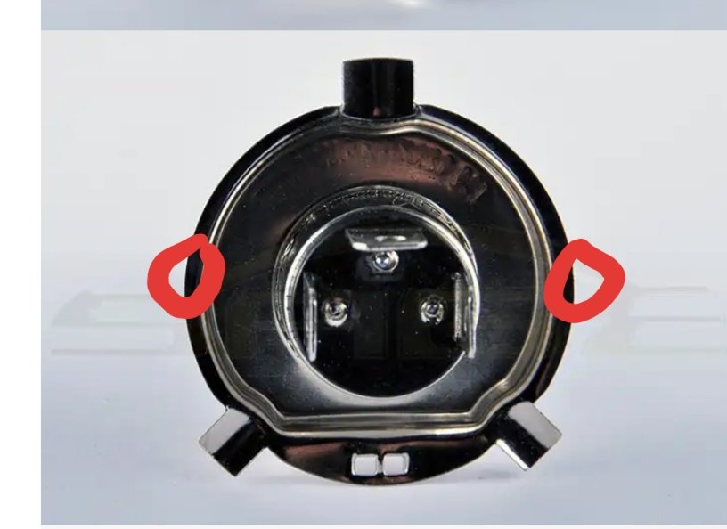

    I recently needed to replace a headlight bulb in a 2006 Tacoma. There is a small wire clip, when attempting to remove a piece of the plastic shroud where the wire clip rest broke off. At this point I assume I have to replace the entire headlamp assembly. Can anyone verify for me that my assumption is accurate. For the want of a small sliver of plastic I think I am stuck replacing the entire assembly. Am I correct?

    Put a couple little Phillips screws right into the plastic between the edge of the bulb and the housing
    Be gentle so it doesnt crack to much, might need to remove the housing for better access
    Housing is already damaged so its worth a shot

    The square block has a round hole in it. Some TW members have put a screw in the hole with a washer to hold down the clip.

    The reason I originally asked for pics is that sometimes - but not very often - the mount doesn't actually break. The clip just falls out. Say for instance 1,650 miles from home in a cold hotel parking lot when I told the wife it would take me "5 minutes" to change a burned out passenger side headlight bulb. Yea, even just the clip is a mother to put back in when your hands are just short of frostbite.
