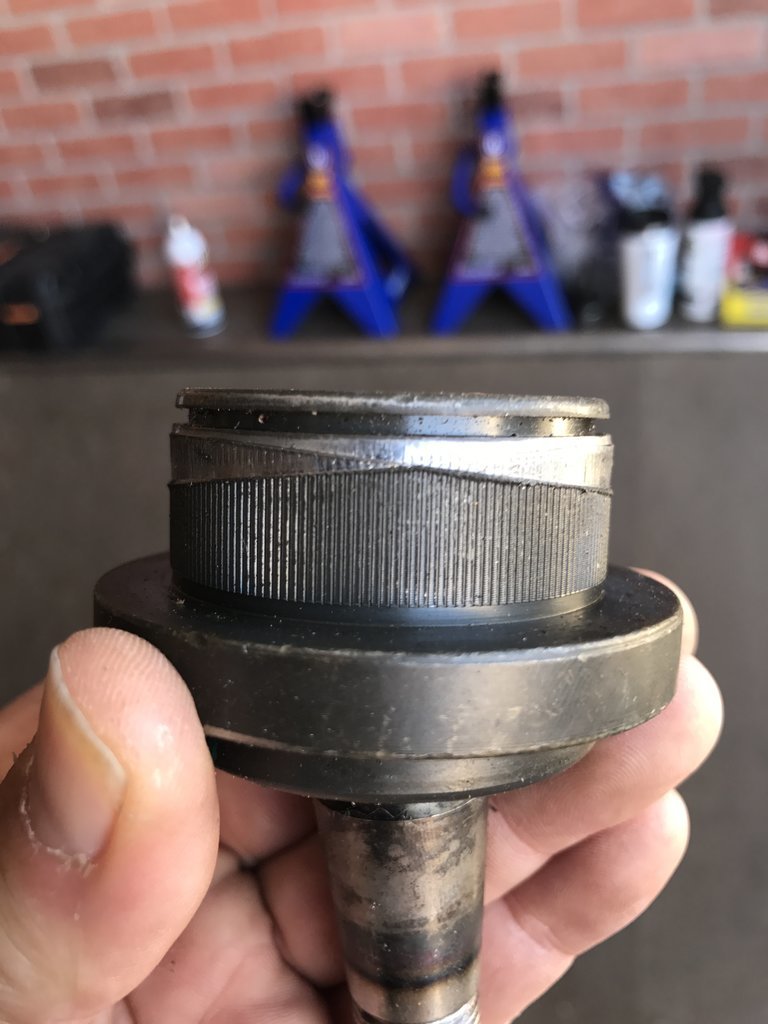

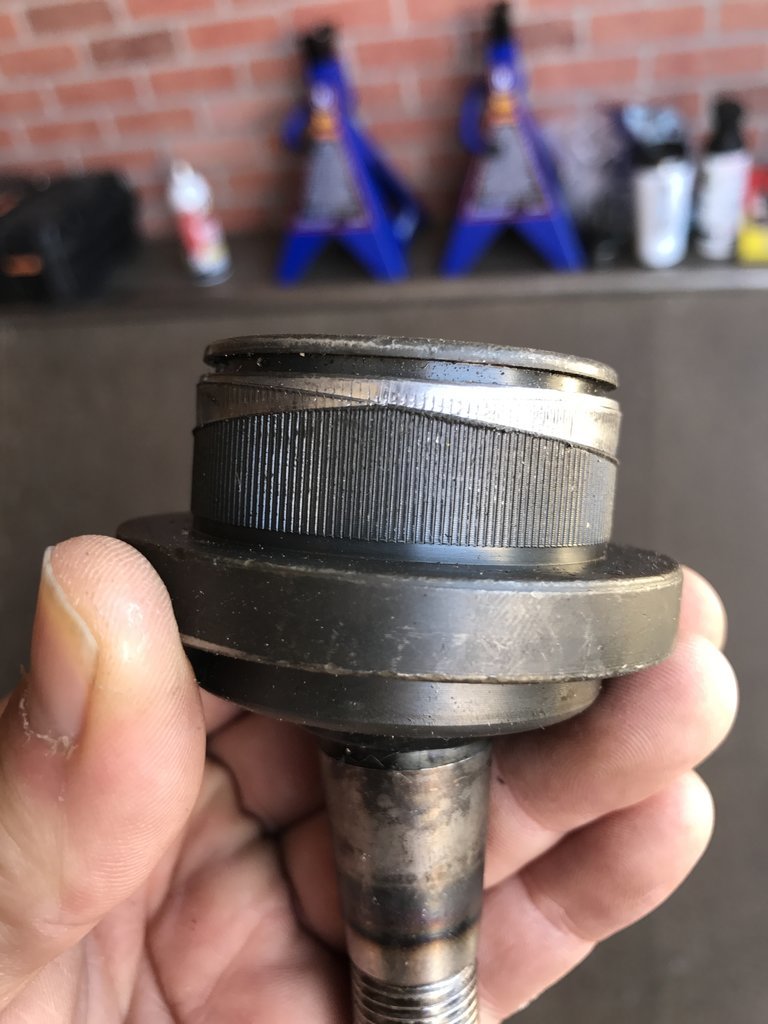

    Wanted to throw another little photo dump here of my lower ball joint replacement. Here are a couple of pictures of the first Moog joint that I used on the first & second attempt at getting it in...
    You can clearly see the angled lines where the joint went in crooked (twice) and pushed down the "threading material" that I believe is used to help keep the joint in place. I don't know the proper nomenclature for this. I had ordered two of these, one for each side, and decided to put this one aside and use the second new one. Not sure if this is enough to compromise the overall functionality of the part?

    Just for reference, those are called knurls. Press in wheel studs utilize the same feature. The theory with the knurling on balljoints is that they will still seat properly in a hole that has been hogged out slightly from wear or replacing the balljoint regularly. The down side(not really down side, but something to remember I guess) is they will also score the bore slightly so next time you replace them you will have to get the knurled ones also. That smear on your scrapped ball joint knurls means that the bore on your arms is still really tight:). It probably would have been fine like that though, keep them as spares.
    I have no idea if the oem joints are knurled or not. I've only had my truck since July and luckily haven't had to do much to it.

    Knurls!
    Good to know. I will prob go ahead and still use this for the passenger side! :thumbsup:
