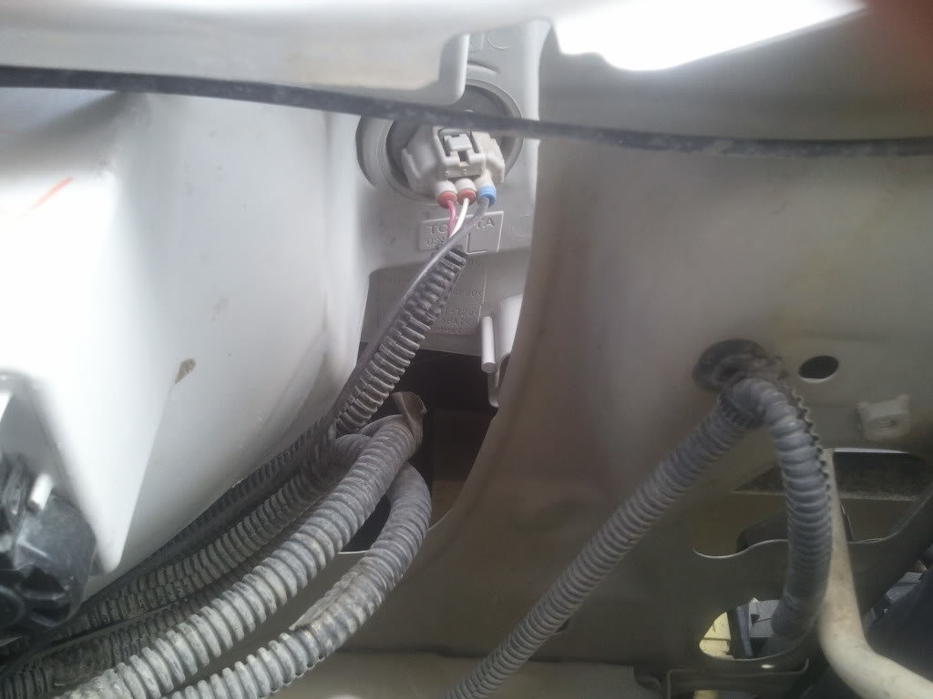

    I just tapped into the green wire on the parking light harness as shown here:2011-10-25124647_04522a0f9fb6cbc89159e8a9dec35c132226ae93.jpg

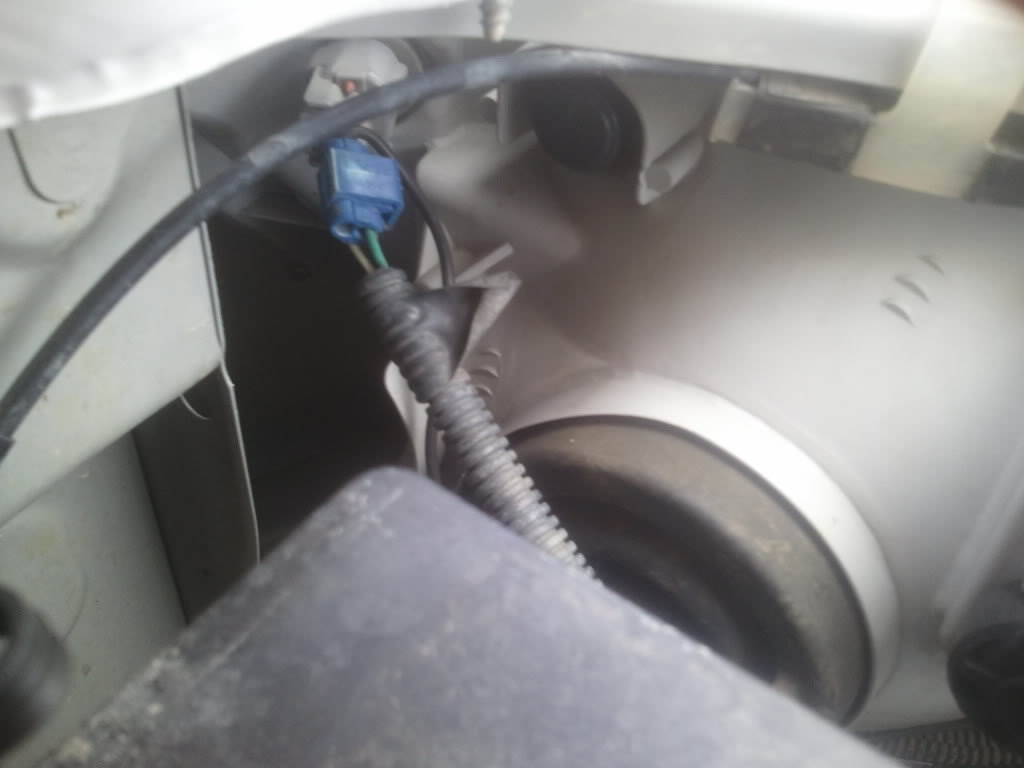

    And ran the wire into the running/blinker light bulb harness n stuck it in the open slot which is one of the three holes(one will not have a wire in it, that's where u stick the wire ur running) like this
    Edit: I used the little blue plug as an insulator on the wire I just poked the wire into the blue plug n put it back in place

    Nope, the running light functions as the blinker and running light all in one. The side marker light is always on when u have the running lights turned on.
