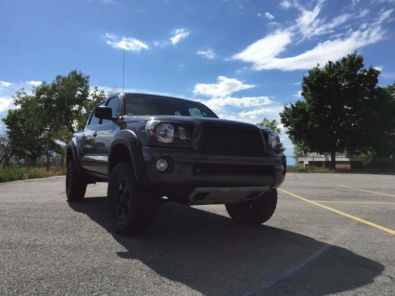

    I replaced my headlights with the Depo brand from Amazon two years ago. Sealed them with silicone caulk when I first got them, and had to recaulk them a couple months ago when water started getting in. The light output compared to factory is crap, lots of scatter and the beam cutoff on both lights is crooked. The clearcoat has started to peel off and the bezel in the passenger side light is kinda loose, it moves a little when I shut my hood.
    All that being said, I'm pretty happy with them for the price that I paid, ~120 shipped. No, they aren't OEM quality but I knew that going in and the light output is livable. If I had to do anything differently, I would have put Expel or some kind of protective film on them before installing to keep the clearcoat from peeling but at this point IDGAF. If these continue to go to crap or fall apart, I'll probably just buy another aftermarket replacement set. Either the Depo or the Ebay brand linked above would be okay replacements for OEM without spending a ton of money. Of course, YMMV.
    Installation is pretty easy, just take your time and put painter's tape on the front of the headlights to keep from scratching them when installing if you've never done it before. Put some anti-seize on the bolt located up in the fender, in my experience it can get pretty rusted making it a PITA to remove later. Headlight removal how-to.
    Here's a pic from a couple months ago...
