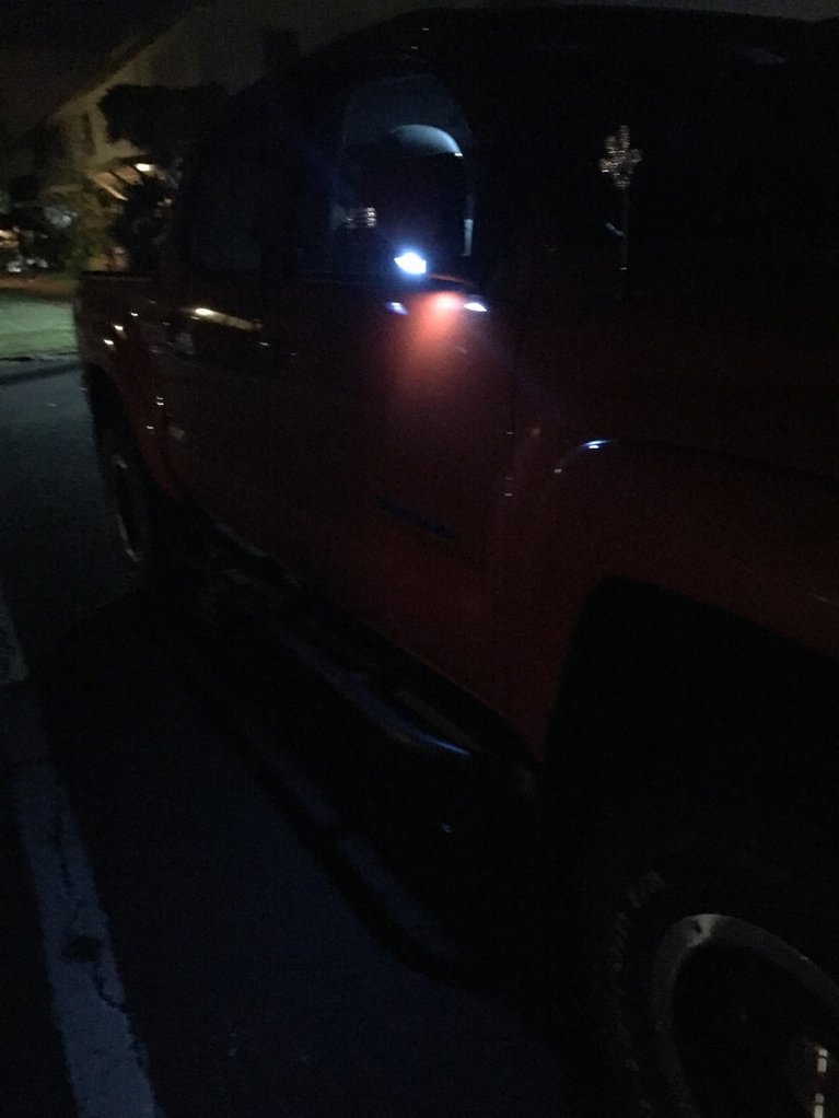

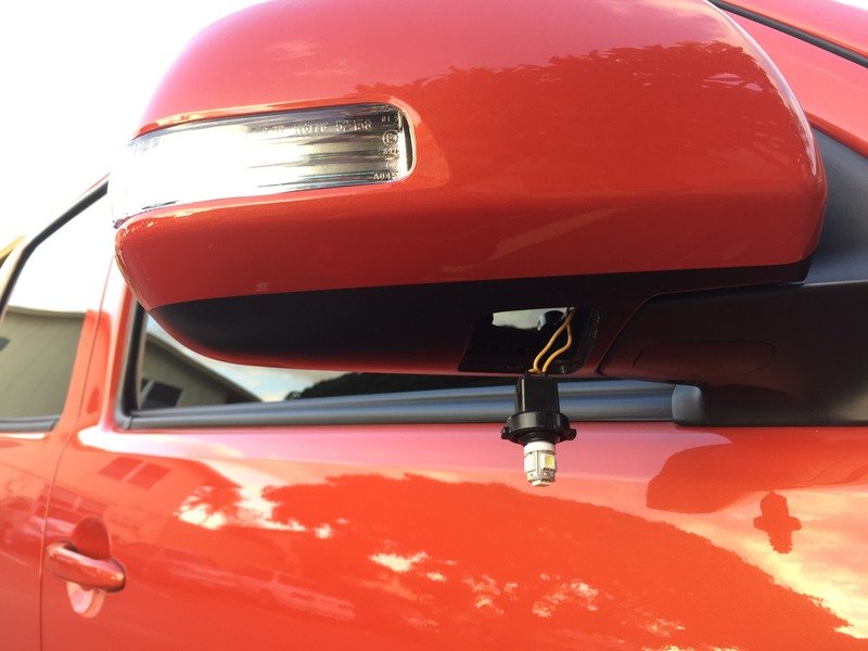

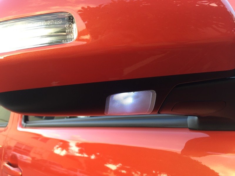

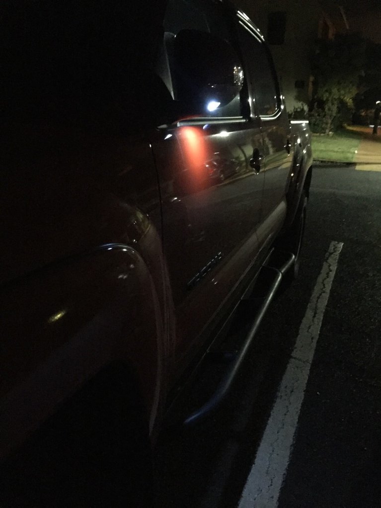

    Reviving an old thread. Had it on my 08, now on the 15 Pro.
    Love that spot/puddle light :thumbsup:
    98482698-E3A6-430E-ABB4-19F92E8B1EAE_zps_22fece0717f7496fdff5a0666fc178fe0cd6c2de.jpg
    271D3723-FC26-4E13-AF0E-C11DCB3BD22D_zps_acfdfbd3d0b070f6847c23db6a935185f9badb3a.jpg
    Looks a lot better in person. Lights up both side really well.

    Looks great, to replace the bulb to led, just pop the clear cover off?
  10. Nov 1, 2015 at 5:04 PM
    #470
    adio
    adio Well-Known Member
    Sep 11, 2008
    #9165
    2,637
    HI
    2015 INFERNO TRD PRO
    There's 2 screws holding that clear cover. Pop the mirror first then you'll have access to those screws. The pita part was swapping out the covers.
