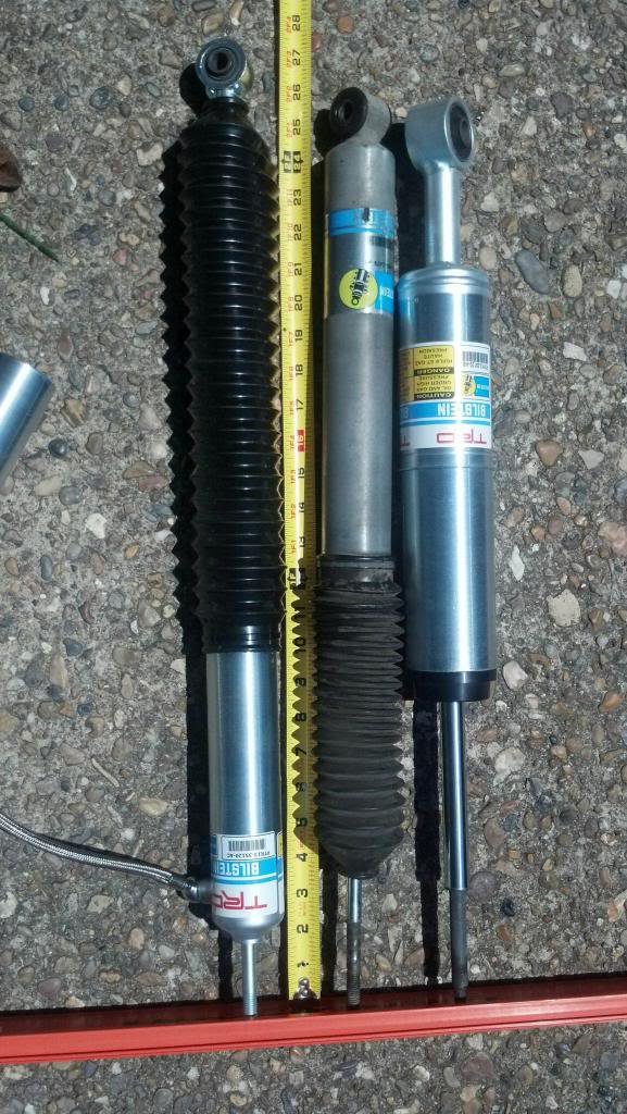

    I have a baja and already did the cab mount chop, and have my angle grinder & dremel ready once I burn my money on some new tires. You will rub fenders even under normal conditions.
    I just had the truck out in moab and really pushed the truck. Quite a few people on here were impressed. It is not just 5100's. I slapped a plate steal bumper, winch, full skids and sliders on it and she still handled everything I threw at it....Now I want more. I have 700# Eibach springs ordered and I am about to order UCA, but not shocks. The stock baja shocks have room for even more travel only swapping UCAs. I am not sure about the rear, but lets be honest that is the cheap end.
    Got this from this thread.
    http://www.tacomaworld.com/forum/2nd-gen-tacomas/277344-because-baja.html
