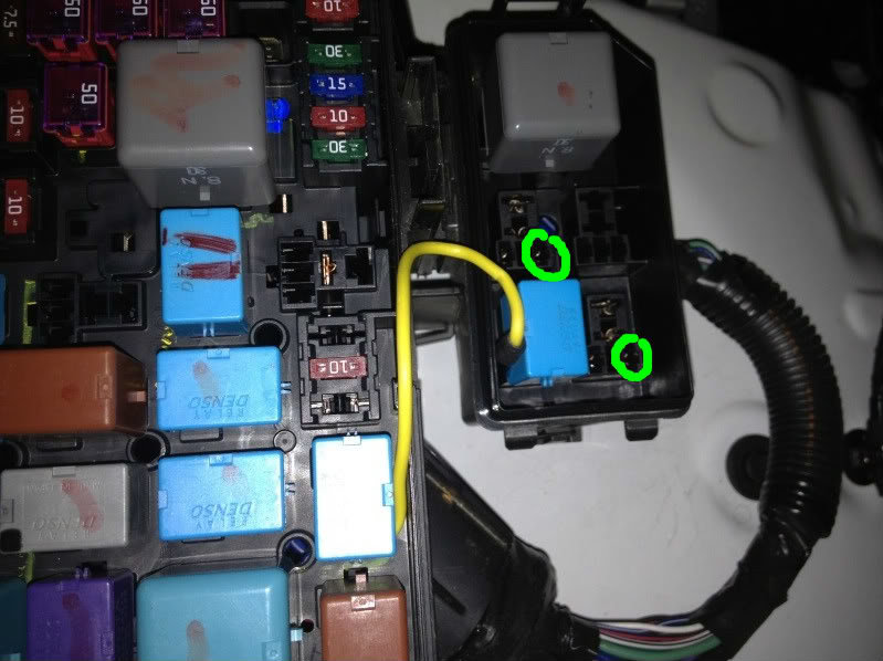

    Have you heard anything or tried the lower right power source? I am looking to complete the same project. I am presently hooked up to the trailer toe relay but would like to have all wiring under one cover - I assume this is your goal as well.

    ok guys i used the upper green circle on the pic for the foglight mod... hadnt had the lights come on until last night.. luckily walked into front of the house and saw them sitting on with the truck off!!!! make sure if you use that spot to turn the switch off this is the only gaurantee they will not come on..

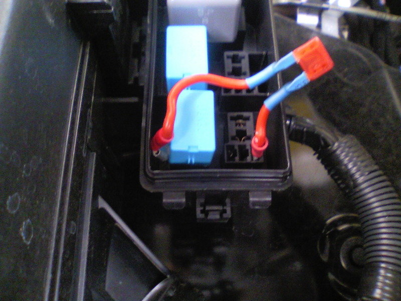

    Ok, so this is what I did... I figured it was just the small box lid that needed to be modified slightly...
    So first I sanded down the plastic on the inside so it wouldnt hit the connector. then drilled a tiny hole in the lid, right where the top of the connector would be... so that way the wire would go straight into the hole from the connector... hope that makes sense..:)
    The Hole is small enough so that the wire insulation is creating a tight seal... ( I may do a gromet later on)
    But te big box is just fine, doesnt need any modifying.. the lid fits around the wire just fine....

    I hooked mine up exactly like this and it works perfectly! no problems
    Thanks nut for posting this pic

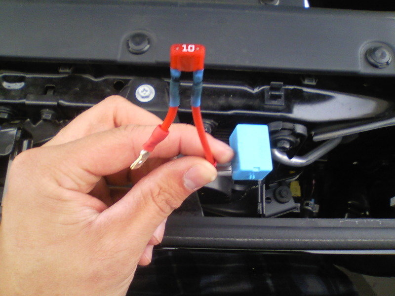

    anyway here's what i did. used the bottom right green circle i just used some 16 gauge wire i had laying around and soldered it to a 10amp fuse.. added some heat shrink.. and plugged it in. fog's shut off when the key shuts off.. i can use them all the time or none of the time. they come on with parks, DRL, low beam, or high beam.

    I just did mine this way by moving the green wire and the red and black wire. The fogs go out with truck off and the button still on with key in OFF and the ACC position but fogs are on in the ON position. Its nice and clean and no one would ever know it wasn't done from the factory this way.
