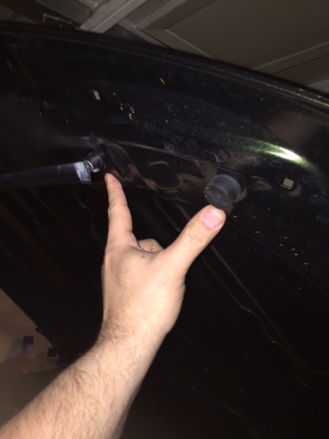

    Love your detailed build! The ARB bumper write up gave me the little extra courage to take on a project I haven't found a record of. I ended buying an ARB for the '05-'11 Tacoma and made it fit my '14. It took a little of cosmetic cutting on both the truck and the bumper, but no modification was needed on the mounting. I took a lot of pictures of the process, but I haven't put together a write up yet. If anyone is crazy enough to cut on a new bumper/ truck, let me know, and write it up. The '05-11' bumper sticks out 3" less than the '12-'15 bumper.
    The gaps under the grill will be a little off.
    I took this picture with the tape measure in the same place as you.

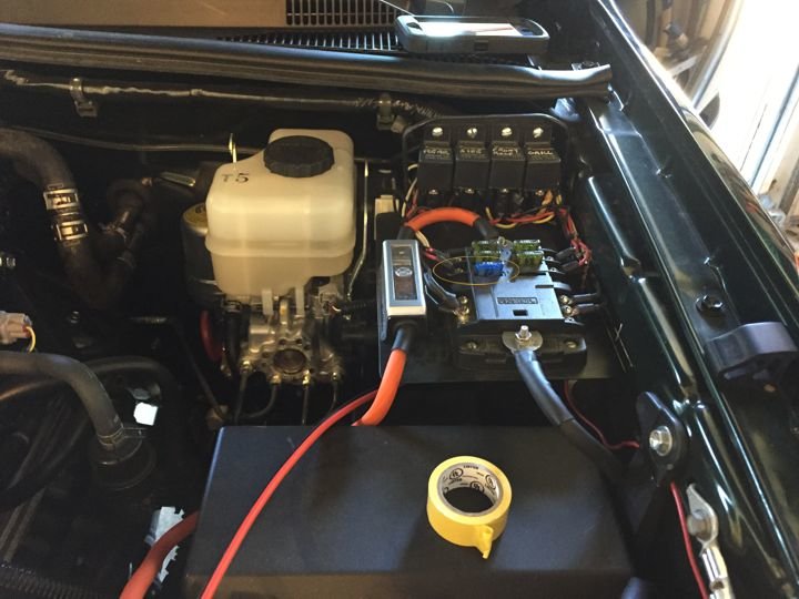

    Well, here is another mod:
    Ham Radio Install 2012 Taco
    Hello everyone, I have a recent mod to my truck. I apologize for not detailing this as I normally do; however, we were rushed to finish this all in 2 days before a trip to Coco Beach FL for a wedding. We got there a few days early and toured KSC. I love the real space stuff, and I got a kick ass T-shirt that simply says, “Occupy Mars”.
    So, I have had an amateur radio license for several years after some convincing from all my Army Ranger brothers. The Bat boys feel that an alternate form of communication is required in this day and age of terrorism, and I agree. CB does not have the reach and functionality we want, so amateur radio was the logical choice.
    For the longest time I have been happy with my handheld radio but where we go camping in North GA it is very mountainous and the desire to work on simplex (line of sight radio to radio with no public repeater) is difficult to do. The solution is to have a vehicle radio that can act as a repeater. Park the truck on a hilltop and have comms for a usable distance in all directions similar to a retrains site in the military. Many of my brothers have such radios and I have been dragging my butt to do the same.

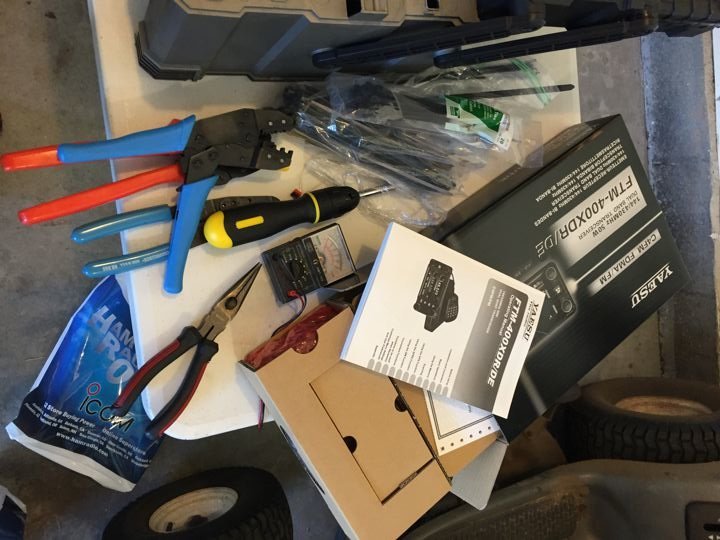

    So, I finally decided to bite the bullet. I purchased a Yaesu FTM-400XDR for the hefty price of ~$800.00 with some rebates from Ham Radio Outlet (HRO). This is a C4FM FDMA/ FM 144/440 MHz Dual Ban Transceiver that can pump 50 watts. I also got a ½ wave antenna, wiring, and an aux speaker. The radio specifications are here:
    https://www.yaesu.com/indexVS.cfm?c...EFF8482F3367495319&DivisionID=65&isArchived=0

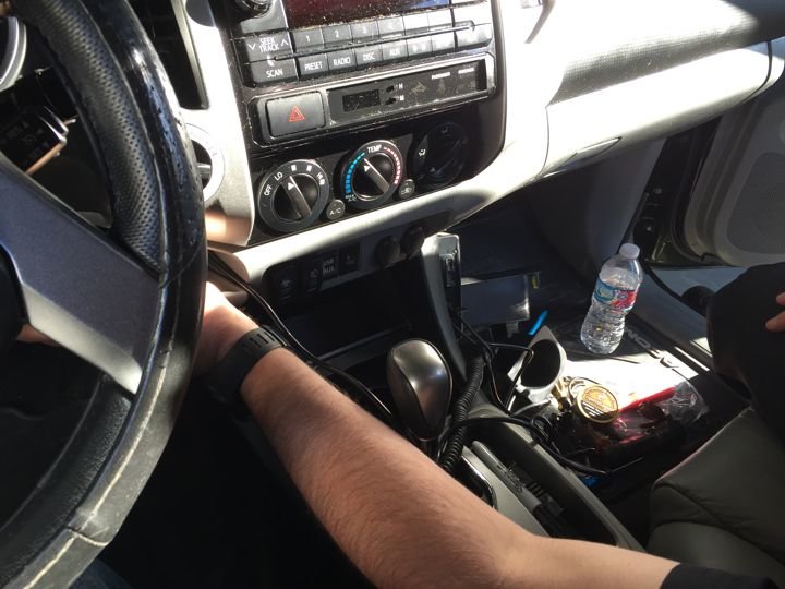

    Since I have 2 open slots in the fuse panel, I installed for my lights back in 2012 (see my build) I used one of those slots to power the radio. We ran the wiring from the engine compartment through the fire wall using the existing wire harness boot located under the dash above the parking brake.

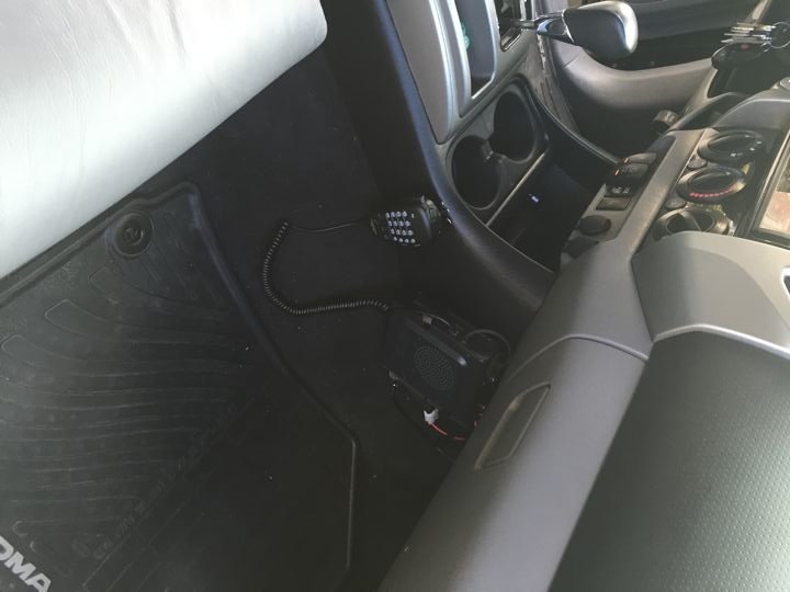

    This radio has a main body and a separate head unit. I mounted the main body to the side of the center console on the passenger side. We ran all the wiring under the dash against the firewall and zip tied it in place. I added an auxiliary speaker and mounted it in the cubby to the right of the steering wheel where my arm is.
    If the stereo looks dirty, it is, My Rhodesian Ridgeback sheds, and I drive with the windows down so his hair gets everywhere.

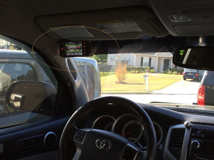

    We mounted the head unit next to the driver’s side A pillar. The head unit has an internal GPS, so it needs to be in view of the windshield. It is also touch screen and I did not want it to sit in the sunlight, so the A pillar was the perfect location for it. The mount that it came with was bent and forced into the head liner and it holds the face plate perfectly. It does not interfere with my field of view and is accessible.

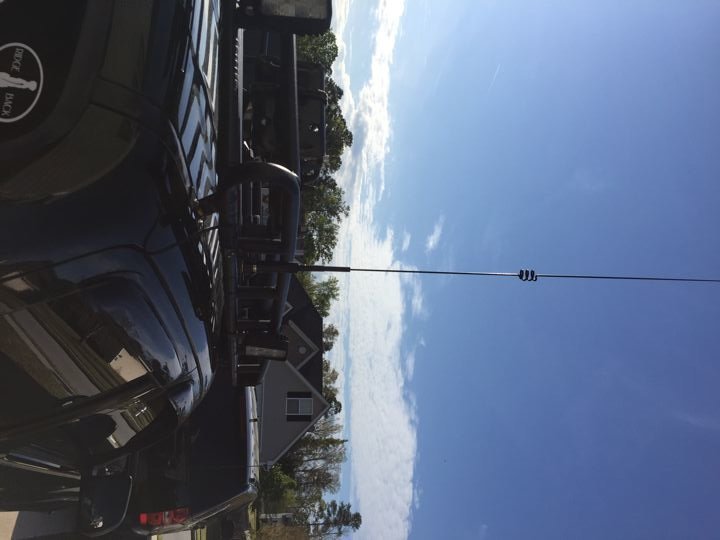

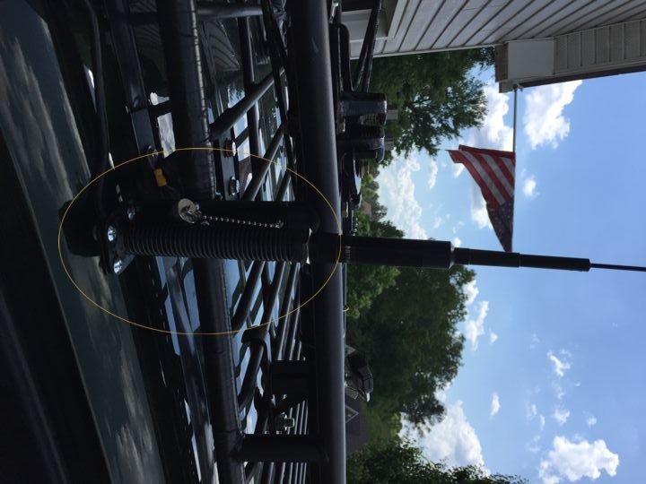

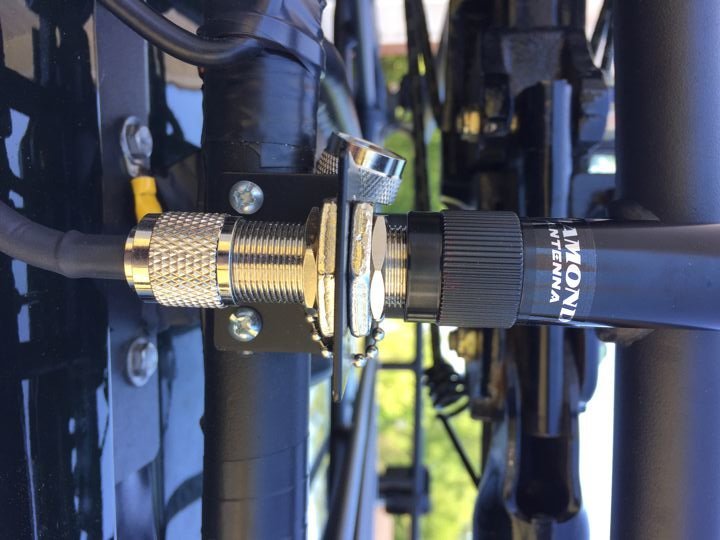

    The antenna is 38” tall and I wanted it as high as possible, so I mounted it to the roof rack and ran the wiring under the carpet along the passenger side. The issue with mounting it on the roof rack is that it is susceptible to being broken by a low hanging branch or even in a drive through. I mounted it on the passenger side to minimize some of this and the antenna can fold over when not in use but in the woods, it would only be a matter of time before it broke and $50.00 for a new antenna is not cheap.
    For some reason the ham radio community in the US is not as interested in ruggedized antennas and mounts as they are in Australia. I can get a heavy-duty spring mount from California or Australia for $350.00 but I was not interested in spending that kind of money. So, we welded up a spring mount and painted it with KG metal coating 2400 gun coat and cooked it at 350 for 1 hour.
    I really needed the spring mount to keep from snapping the antenna in the woods. Well, that’s it and now I can talk to Germany, the UK, hell even the International Space Station all from my truck.

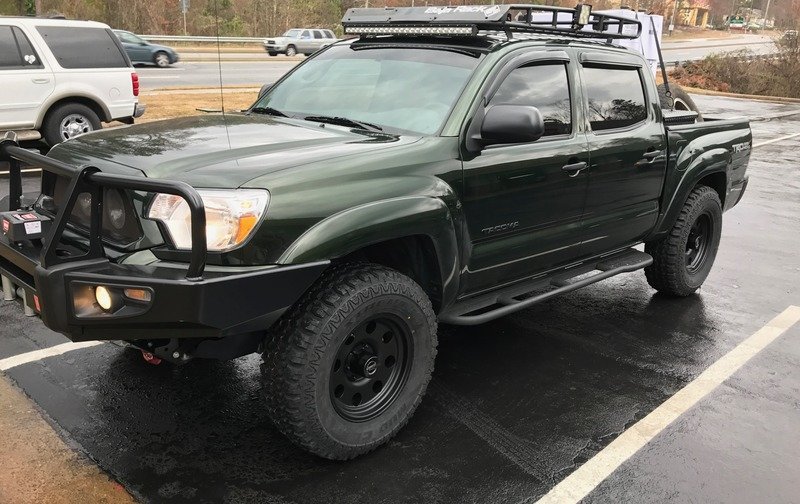

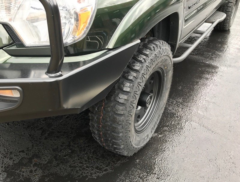

    So I finally got new shoes and socks. American Racing 17x9 Baja Wheels in satin black, Black lug nuts, and 285/70-17 Mud Claws. $1,369.00 total. I have not done the CMC or trimmed anything yet. I am getting very minor rubbing on front inner plastic liner with the wheel at almost full lock in reverse but nothing else. I plan on clearing everything soon but for now its good to go.

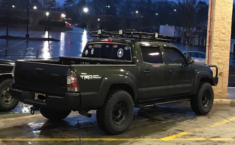

    This is how my truck looked in 2020.

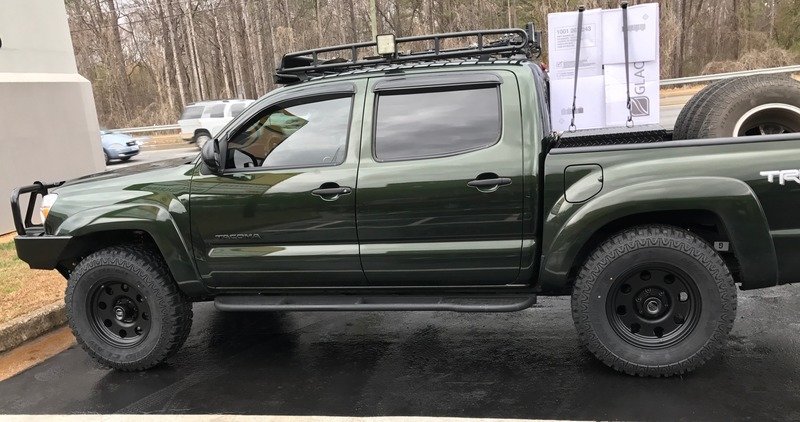

    Most recently, I Decided that I needed to replace the Mud Claw tires. Those things lasted 25,000 miles at best. They got to the point that I was constantly skidding in the rain so time for them to go. I decided to replace them with BFGoodrich All-Terrain T/A KO2 285/70R17 Tires. These are the E load with 10 ply and the S speed rating. there are several versions of the KO2 but I prefer the 10 ply in all my truck tires. I had considered the General grabber ATX. This tire is an outstanding tire and widely used by Expedition overland but the KO2 seemed the better of the two. The General is a bit cheaper and next time I will probably go with them unless the KO2 really impresses me.
    Here is a pic of my truck as it is today with 45,900 miles on it.

    Jumping in:
    I ordered a used center console off ebay.
    This is what I started with, note the heated seat switches and the roof rack light switches. I never liked this location for switches.
    So, after extending the leads on the heated seat switches, I added them to the replacement center console. The roof rack light switches were moved to the 8 gang box.
    Since I was moving all the switches to the 8 gang box, I could remove these two light switches for the front light bar and grill Hella lights.
    I got some blanks to fill the holes and modified one for the DTRL switch.
    Then installed them.
    This is how all the lights were originally wired.
    And this is the 8 gang system installed: I looked at a lot of systems but chose the MKING 8 Gang Switch Panel.
    https://www.amazon.com/dp/B0CJTTYDPP?ref=ppx_yo2ov_dt_b_product_details
    Much cleaner and I wish I had gone this route originally but I don’t think they even existed back then or they were insanely expensive.
    Next, I had to figure out where to put the switch panel. I ended up going with the fuse cover coin tray. I had to do some cutting but it fits nicely and folds away when not in use.
    Next, the decals that came with the 8 gang system were good but not specific enough for me so I made several that I wanted to use.
    And here is the 8 gang panel installed.
