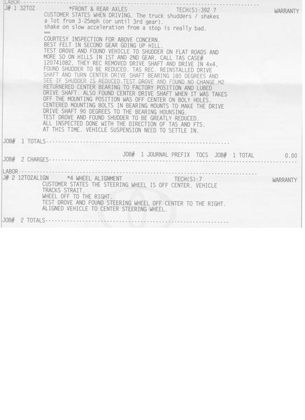

    Here's the scanned image from the RO (repair order) that describes how they reduced the shudder. Again it's not fixed, just reduced. I'm going to contact Toyota USA about getting this fixed.
    Note: RO also includes the summary on the steering wheel off center from the factory, they fixed this the right way by adjusting the tie rods, not removing the steering wheel, nice.
