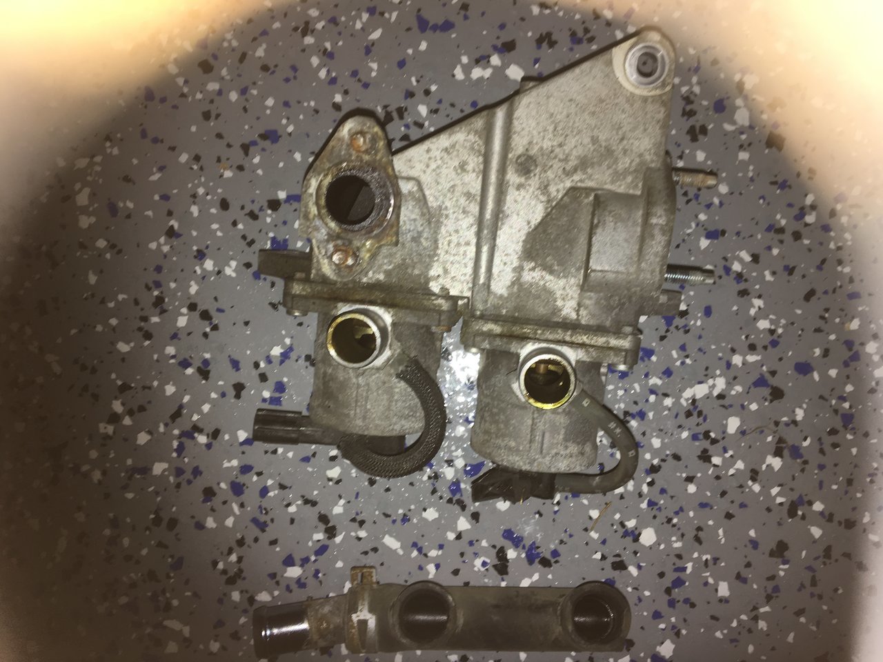

    Hi Forum members. I wanted to make everyone aware of the issue with 2012 Tacoma Air Injection Valve and Pump Assemblies. These parts are defective in that they allow water into the unit, seizing it up and resulting in warning light and loss of engine power. This was a known failure in Tundras resulting in recall replacement with new part design to eliminate the problem. Toyota while acknowledging the issue exists with 2012 and later Tacomas, has NOT initiated a replacement recall. The replacement of these units will cost you around $2,000. Yes, I said $2,000. Do not call the "customer experience" number and complain or request reimbursement. They will, as in my case, politely acknowledge that while you have owned 8 Toyota trucks and 1 car over two decades, decline to reimburse you for the cost of the parts and labor charged by the dealership to replace the parts.IMG_3581.jpg IMG_3581.jpg IMG_3581.jpg IMG_3581.jpg IMG_3581.jpg IMG_3581.jpg IMG_3581.jpg This is unacceptable. I have filed a complaint with the NHTSA regarding this issue. DO NOT purchase this year of Toyota unless you can confirm with the dealership that the part has been replaced. Request the service record confirming the same. Good Luck!

    You have pics of what you are talking about

    I suggest getting one of these unifilters (linked below) and take out the crappy foam filter inside your pump since you have a 2012, before it causes you problems
    Edit: looks like you already ran into this problem.. id still install one for cheap insurance going forward
