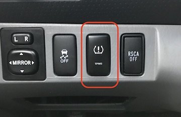

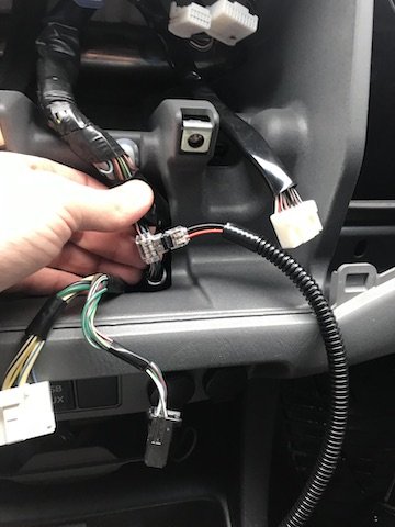

    Did this mod and put it on a switch if anyone is interested.
    Would be a good solution for someone who runs different tires in the winter or if you're like me and you don't want to replace a dead TPMS now but will likely do it next time I get new tires.

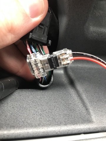

    One thing to note - You don't have to cut the blue wire. You just have to make the connection between red & blue. So I put a T connector on the blue and red and ran them to the switch. When I push the switch, it makes the connection.

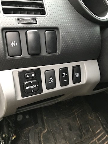

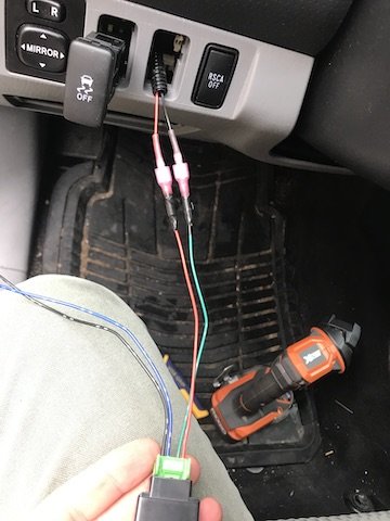

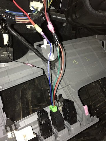

    The switch I use has 4 wires. It's made to light up at night with the dash lights.
    Red Wire - Power in from TMPS red wire
    Green Wire - Power back out to TMPS blue wire
    Pushing the switch makes the connection between red and green.

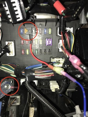

    Blue Wire - Power in from dash lights. I tapped into my tail light fuse so it would come on anytime the tail lights are on.
    Black - ground

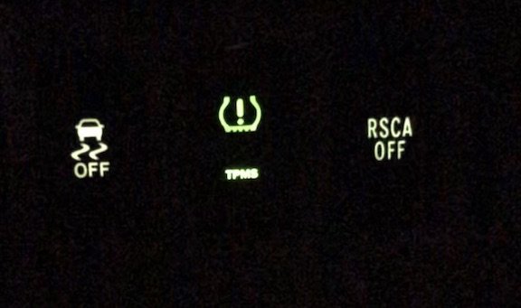

    The switch came from air_on_board_usa on eBay. The 'TPMS' lights up with dash lights, and the tire logo lights up when the switch is pressed.
    I think of it as a TPMS 'bypass.' When the switch is on the bypass is 'on.' It's a bit counterintuitive because the switch 'on' does NOT mean the TPMS system is on.

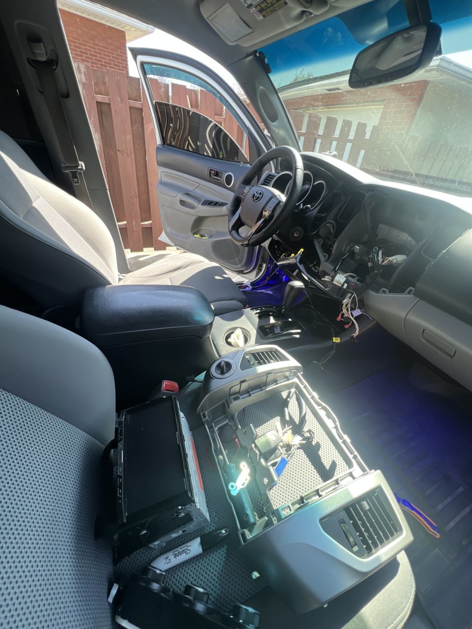

    Just did this on my 2008, took MAYBE 20 minutes. Remove the bezel behind the radio for easier access. Had no issue getting the plug out/back in. I used a splice but drilled out the stopper so I didn’t have to cut the blue wire.

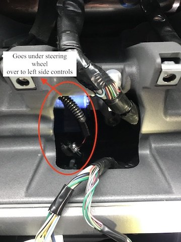

    this is the fix I used to install a jumper to disable the TPM light. Sorry that you have to open a file to see the pics.
