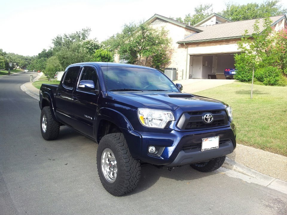

    I have a 2012 DC Sport with 4 leafs in the rear. The rear was exactly 2 inches higher (hub center to fender) than the front. I set the 5100s at 1.75 in the front..and it came out perfectly level.
    Maybe try putting the 5100s in the rear, you are missing out on the whole point of a better ride with the 5100s.
    Good Luck

    Your truck looks awesome! I've got the same truck (but in black) and I've been debating what kind of kit to put in it and now I know...5100's @ 1.75 here I come!
    What size tires are you running???

    Thanks, I did a lot of research cause there is so much contradictory information on here.
    265/75/16. But I think the key is my wheels are 16x 8.5 (not the usual 16X8). I think the extra width gives tires a beefier look and dura tracs have that aggressive profile. I am real happy with how it came out and get lots of compliments in person.
    It is an everyday driver for me and I planned on lifting it 3 inches. But I was already having to climb into it at stock height, so I thought I would just give the 5100s a try for an interim solution for under $500. Cause if you really want to really do a lift correctly it will end up costing $2000 for that extra inch or so to get it to 3 inches.
    So this worked out great for me.

    I am like you, I like to do things right or dont them at all and I was going to get the ULK, new UCAs, everything to do it right. (those red coils are almost as cool looking as a fake hood scoop!) But like I said the truck was high enough already and the 1.75" leveling worked perfect for me and I am completely happy
    Before the 5100s, but with the aftermarket wheels & tires(and this is with 4 leafs in the rear from the factory):
    The measurements from center hub to fender were:
    front: 20"
    Rear: 22"
    Now it is basically 22" in the front(there is slight difference right to left, of less than a quarter inch, so it is is imperceptible to the eye). The alignment came out perfect with no problems after the front lift. I get 16mpg in 50/50 city/highway driving. I was getting a little more than 17mph before the tires/lift. I havent done a lot of pure highway driving. Let me know if you have any more questions.

    So does this Setup in this picture require the tsb AAL?? I asked Toytec if I would require the TSB AAL and they said I would require the TSB AAL??? I am confused

    Nothing is "required". Of course a vendor is going to tell you that you need to buy from them. It is all about what you want. Leaf springs are man made and thus none come out the same. As I stated above. Directly from the factory my truck came with 4 leafs and the distance between the center hub and fender was 22" in the rear. I am sure there are people with 3 leafs with 22". And there are probably people with 4 leafs that have less than that. So measure what you have on your truck and go from there.
    For my truck the rear was 2" higher than the front, so it was simple math to set my front 5100s at 1.75".
    If you only have a 1" difference then you set your front at .85 or you get a 1.5" AAL and then set your front at 2.5"
