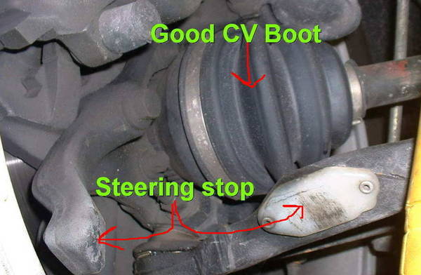

    Can somebody give me a link to a pic of a steering stop as it should look on a Taco? I guess I can compare the two sides. Here's the big issue. 3 spine surgeries in a short period, makes it hard for me to climb underneath. I've done it twice to look with it at full knock to each side and not seen anything out of the ordinary. But I'll do it again before I drive the 100 miles each way to the dealership. The dealer in town isn't trustworthy. I won't be taking it to them for service no matter what. But it's nice to have the warranty when needed. If it's just something mild like needing a small part replaced I can email a pic to the service guy and I know he'd mail me what I needed for a self install. They're cool like that and don't want me to have to take a whole day out for a minor inconvenience because I go there for all regular services.

    I think this might be it:
    http://www.tacomaworld.com/forum/2nd-gen-tacomas/11926-steering-stop-cap-write-up-2.html#post1685661
    Here also: http://www.tacomaworld.com/forum/2nd-gen-tacomas/11926-steering-stop-cap-write-up-2.html#post3681356

    So this isn't a pic of a Tacoma's steering stop, but its for a relatively new replacement steering stop for an unknown vehicle:

    I looked at the first pic and compared to my truck. That's the correct spot that I believe is making the noise. I went out and looked at mine and there are no plastic caps on mine. I've never had a noise on this one, but looks like my mechanic has been putting grease on that area for me. Try wiping a little grease on there if you can, or get whoever does your service work to do it for you.
