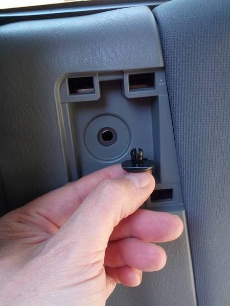

    New 2013 Access cab owner here - first post so hopefully is in the right place.
    I want to remove the rear seat headrests. I have read the posts with instructions for earlier model years (like this) but my backrest just does not want to come free. It looks like it is hung up on the round thing in the attached picture that the arrow points to. I don't see that on the earlier models.
    Any advice for how to get these useless things off would be seriously appreciated.

    That round piece looks like one of those push snap thingys don't mind my uneducated description of it. Does the center spin freely if so try getting a butter knife or small flat head under it and pop it up.

    Tried again today but the things in the picture in my first post just do not want to release. I am afraid of breaking something if I pull or pry any harder.
    So......still looking for advice on how to deal with the round things because I am even more convinced that they are securing the seat panel to the back wall of the truck.

    It is securing it. But it's not a big deal. If you take a small knife you can pop the center out and remove it. If not, a good solid yank will destroy it.

    The only thing I did different was shim a flat head screw driver behind the panel on each side of the headrest (on the plastic panel, not the fabric portion) to help give some leverage in popping the snaps. It helped to easily pop the top snaps. Then I just used my hands to pull the remainder of the snaps and panel off. It will come right off with some moderate force.
    That black push pin goes into the frame of the truck and you just need to get your hands down in there to supply some leverage. I didn't even have to remove that section of the panel your picture shows. The panel is no different then in the thread you read. Just give it another go and good luck!

    I removed the rear headrests this weekend.
    Once you get the center of the rivet to pop out a little, the entire rivet is easily removed.
    With the two rivets out, I pulled the panel out enough to take off the 4 bolts of each headrest with a 12mm socket.
    The headrests are the devil's work and a pain in the ass to remove. Mechanix gloves will spare your hand from the pointed plastic you will encounter. Count on 30 minutes start to finish.

    The engineers at Toyota decided to add a couple of plastic rivets in addition to the regular plastic fasteners that we have all encountered on that rear panel. These rivets must be released. They don't pop out like the others. God knows why they added these things.

    Thanks for the guidance and pics RTN - it helps to see those rivets and how they pop out. I intend to work on it again this weekend.

    Successful with the removal today. Once I pried out those black pop-rivets, the back panel loose fairly easily. Amazingly, all the plastic connectors stayed intact. Very nice to have the headrests removed - completely changes the access area.

    1. Use butter knife to dislodge two rivets on the top corners of back seat plastic (you'll see the compartments you need to expose to see the black rivet.
    2. Don't be a weenie and firmly, but not recklessly, pull the back seat plastic. Work your way around the edges.
    3. you won't pull the whole thing off, just get it dislodged enough you can access the four (4) 12mm bolts on each headrest.
