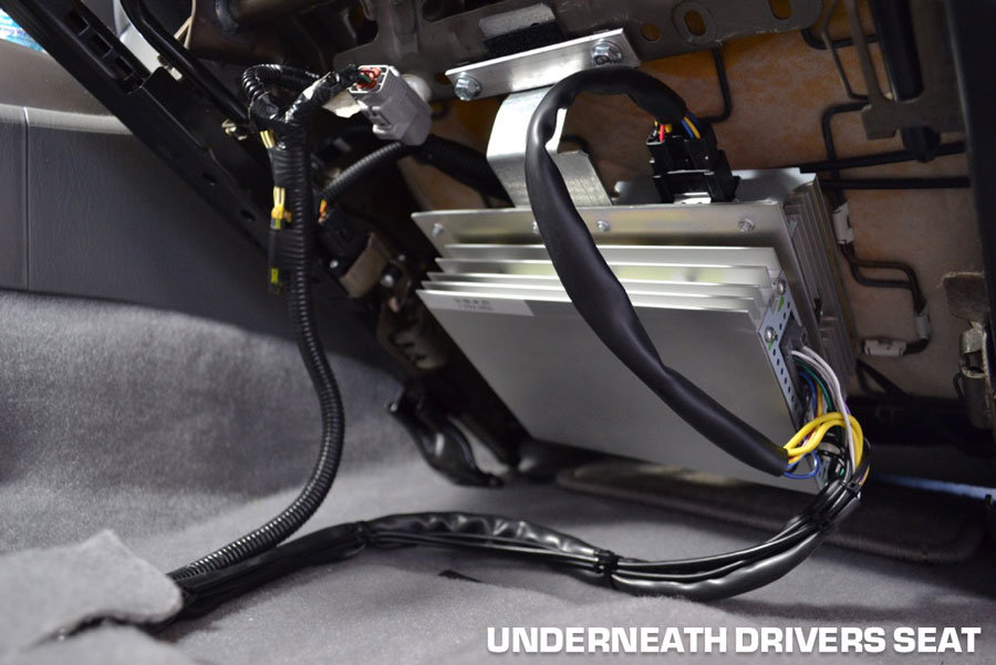

    I've seen a video on YouTube of someone using a bracket that holds the amps to the bottom of the seats like so:91E85BA8-D493-4025-B033-173B7CA2D673-1491-0000023CB14A5D3A.jpgOther than that ********* sells brackets that elevate the amps slightly and use the existing mounting holes for the seats but they cost fucking 70 bones per side before tax and shipping :/
