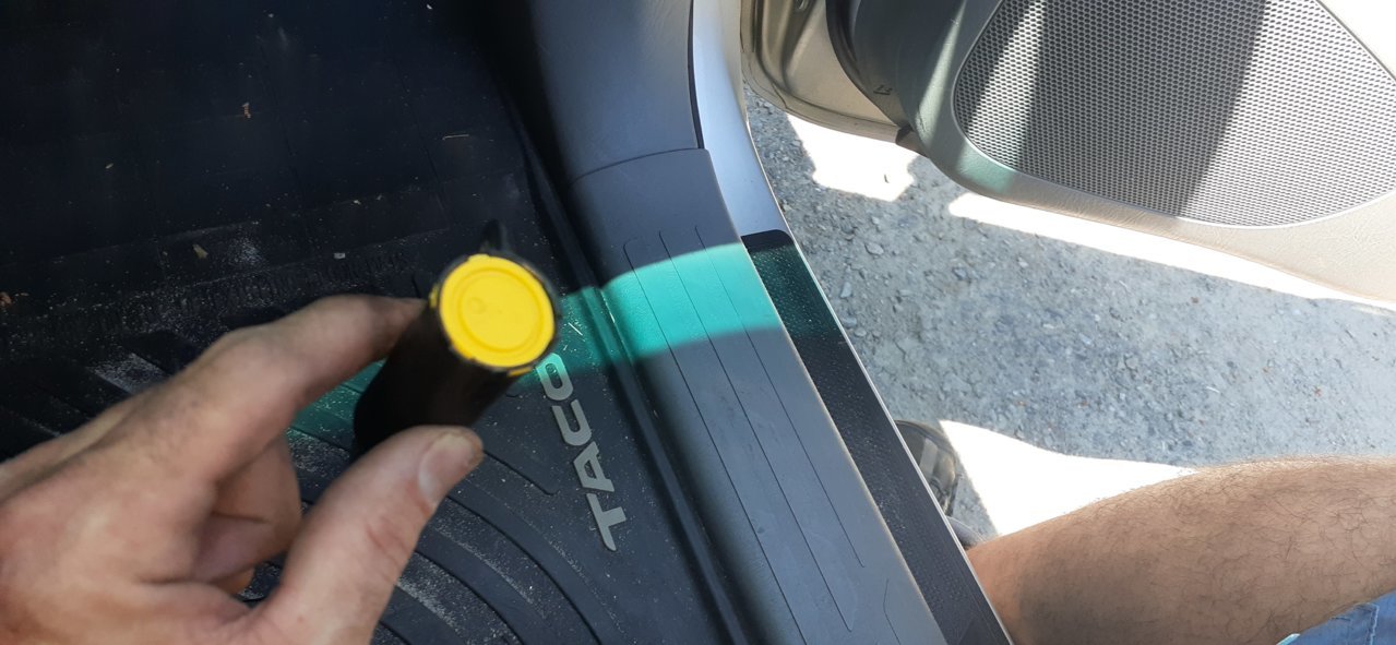

    finally done. radio works. still took me 90 minutes. what is this tbing though. it dropped out when i took glove box out? is this a drug compartment??lol.
    PzTank likes this.

    That's a shock absorber for your glove box. See if fox or king makes a high performance replacement.
    You'll want the triple bypass if you're going to do any serious offroading.
    PzTank, SR-71A and mcl77[QUOTED][OP] like this.

    :rofl::rofl:
    Not the best pic, but you can see how its supposed to be installed here on the right
    PzTank likes this.
