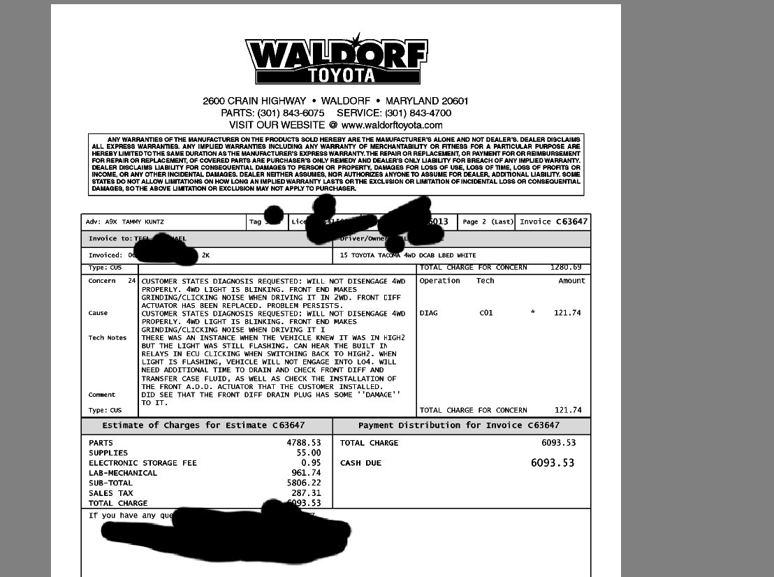

    Update dealer says its transfer case, have never taken it offroad,he said the noise from inside transfer case,but its not the transfer case actuator,want$6k to fix it,I attached printout, I'm not getting that done,they even have ecu on printout, why would 4wd ecu be on there if it was transfer case? I'm gonna just drive in 2wd for now, is there a way to truly make it 2wd? Bypass actuators? So the light still blinking, and at like 15mph and u Der I feel a grinning up front, it feels like front diff but they said transfer case, I did the front diff actuator and same problem, other opinions on troubleshooting? Thanks for any help

    I can smell that BS from here. Sounds like they want to replace the whole system using the shotgun approach because they cannot accurately diagnose.

    Ya, thats just a dealer not properly diagnosing it at all. This is happening more and more now since people aren't being trained properly and doing nothing but warranty work where Toyota will tell them what to replace. It's sad. There are very few diagnostic technicians left, just mechanics throwing parts like monkeys throwing poo at the zoo.
