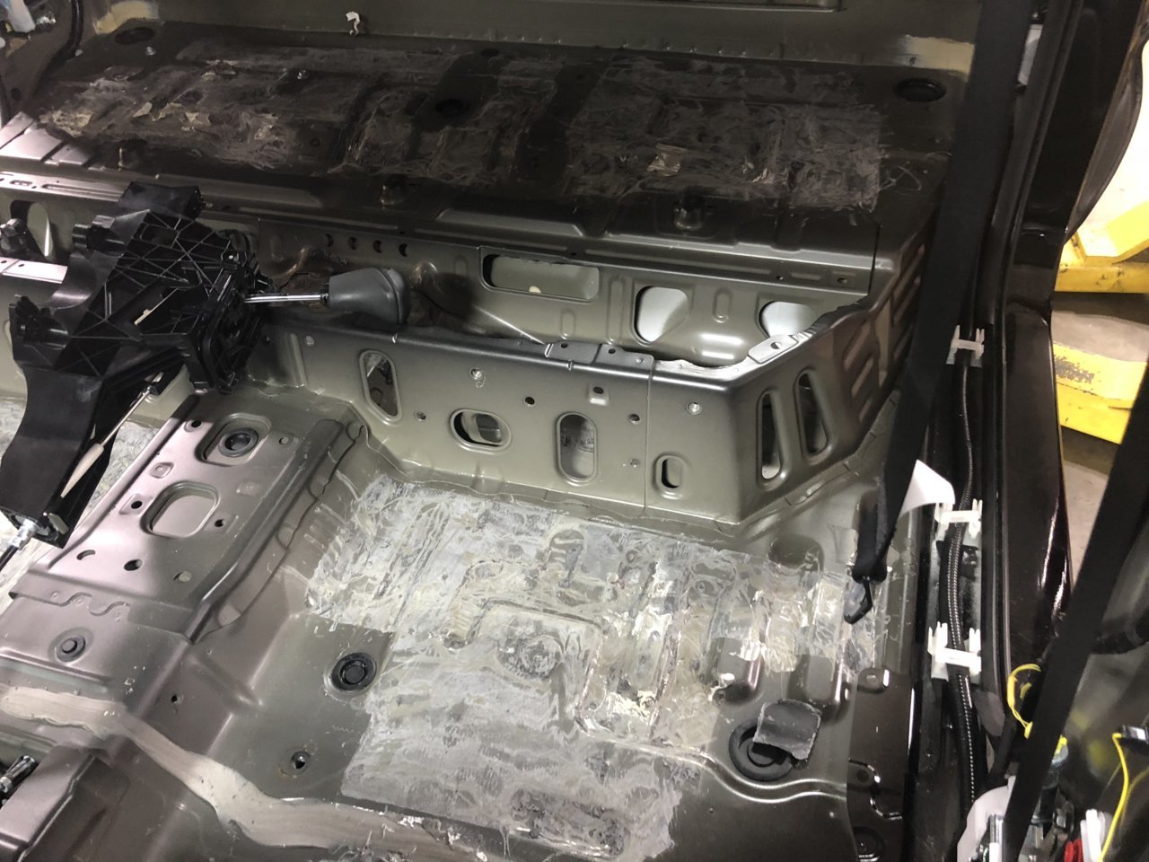

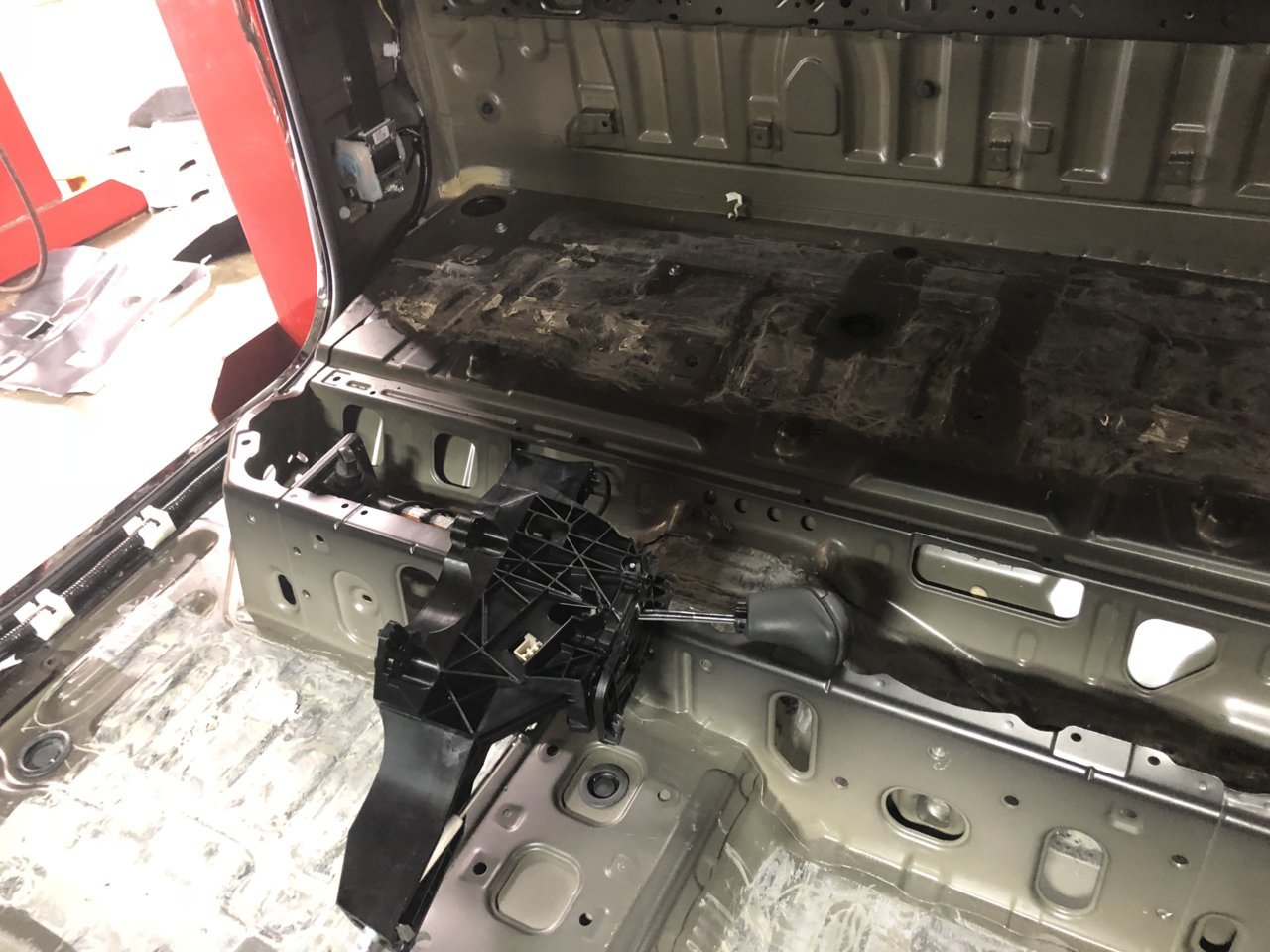

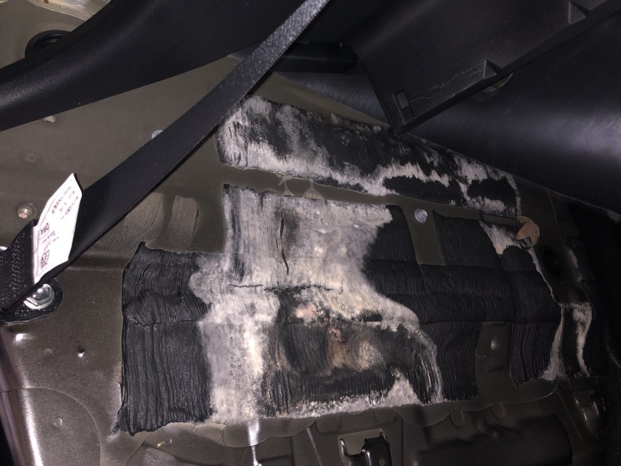

    Still waiting on getting my truck back. Bought my 2017 DCLB Off Road down in GA (from a toyota dealer) on July 29th and drove it back to TN a few weeks later. Noticed that my rear seats and headliner were wet, so I took it in to my local dealer on August 18th. They were a bit backed up that day so they gave me a loaner for the weekend since I took it in on a Saturday. Monday they contacted my after pulling the carpet and it turns out water must have been under the carpet for some time. They found a bunch of mold and the carpet was soaked through still.
    Since my truck only had 24K, I was reassured that everything will be covered under the warranty. This put me at ease, but it now has been 24 days and today I was told it will be probably another week or so since ServPro who came out to test the truck/seats/headliner for additional mold growth has now lost the test results. ServPro now has to come out again to retest everything. My truck is STILL in pieces!
    I guess on the bright side the dealer has let me drive around a Tundra for the last few weeks, but I have had to keep turning those in since the loaners keep getting sold. I am now on my 4th loaner! 2018 CH-R, 2018 Tundra Platinum, 2018 Tundra SR5, and a 2017 Tundra SR5.
    I am wondering if, at this point, I should start requesting Toyota to through in anything else, maybe a paint correction for scratches, leather seats, extended warranty beyond 36k bumper to bumper? Need some help, what are your thoughts
    Sorry for the long post, but I am starting to get irritated with this new truck that I have already paid the first payment on and I haven't event driven in for 2 full weeks.
    Enjoy the Pics!
    MOLD!
    Mold scraped out an ready for ServPro
