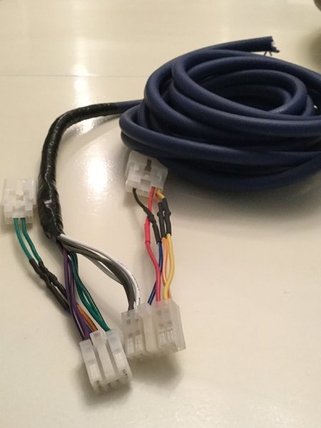

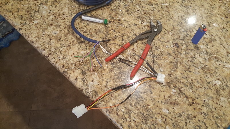

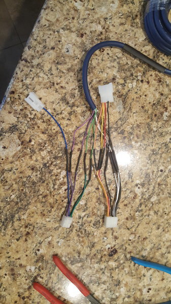

    Started building the harness today. I switched out the orange wire on this harness for one of the blue ones to keep it all uniform.
    BEFORE
    AFTER
    It seems to be going ok but I have been working on other now for almost 2 hours. My advice, take your time and stay organized.

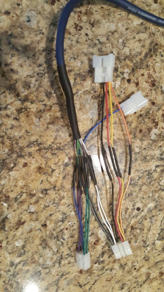

    Done!! Not too bad for the first time I used a soldering iron.

    Cleaned it up with some heat shrink on the speedwire where the wires come out.

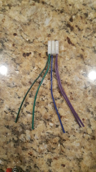

    Awesome. Just finished up mine too. Wife keeps giving me other projects and it's making this taking longer than I want. She seems to think the house is more important.
    The wires felt too long so i shortened them up. Some of the colors don't match. The black ground wire came out of its metal trapper. image.jpg Cheap peice of shit. Gave all the others a good tug to make sure none the others were like that.
    I'll be wrapping them all the wires in the jumper with electric tape before they go in. Just for fun.

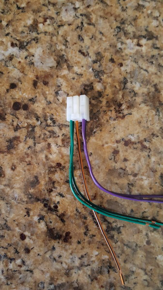

    One question, why do you have two wires on the small plug on the far left?

    I wanted to add that I tested the continuity of all the connections to make sure all my solder points were good. Used a multimeter to do this and all was good to go. I wanted to make sure I didn't run into any problems when it is in the truck.
    I highly recommend to do this.
