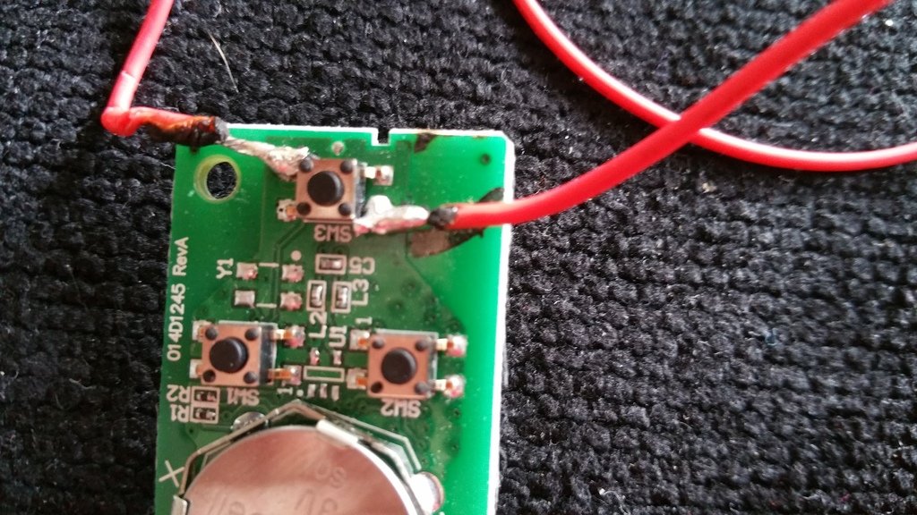

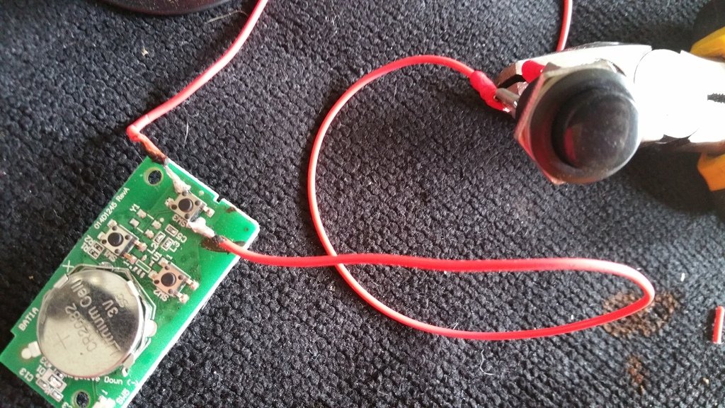

    IF I may this is my answer to Homelink
    There is a blank under and to the left of the wheel. I intend to removed the blank drill it out and insert this home made momentary switch soldered to a keychain opener. I only used one switch but there are three for those who want to turn on lights etc,, The Circuit board will go back in the plastic case and taped behind the dash. I've done this mod with my last three trucks and it beats Homelink.
    Cost: Less than $25 and 10 minutes.....
    http://www.amazon.com/Liftmaster-890max-Garage-Opener-Remote/dp/B0051V41CQ
    THIS is a better switch than pictured Got it today. More flush and has screws for attaching the wires
    http://www.amazon.com/gp/product/B00D0XK32O?psc=1&redirect=true&ref_=oh_aui_detailpage_o04_s00
    As a security addition no one will see a Homelink garage door opener in my truck in the driveway getting access to my home. They work without a key

    Interesting, please show how its done, maybe in another thread
    where do you get the push button?
    pics of how its held to the blank space?
