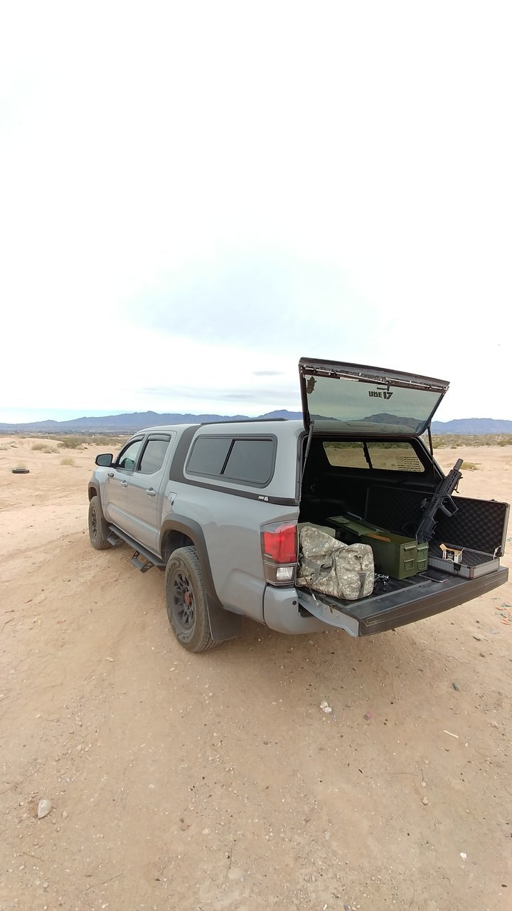

    Negative to both questions. A couple days after I initially flashed 1.03B, I thought I caught a hint of stutter, but I failed to replicate it, ever. I even went as far as to imitate the conditions that people were describing, such as specific rpms in specific gears, driving off immediately following cold start, etc. Could not replicate the issue, and this continued over to 1.03C for me.
  11. Mar 10, 2018 at 4:22 PM
    #3171
    mZiggy
    mZiggy Honey badger
    Apr 8, 2017
    #215707
    4,709
    Marc
    2020 MGM Tundra SR5; 2020 4R TRD Pro; 2008 4R SR5 v8
    t'was a good day to burn some brass and explore some trails out in the desert

    Now that looks like a fun weekend....

    Sweet lookin truck!

    Thank you! I need to swap to sliders though. Getting tired of scraping the predator steps every time I crest a hill lol they're certainly sturdy and well made though. No bending or damage even though I've certainly gouged the earth enough
