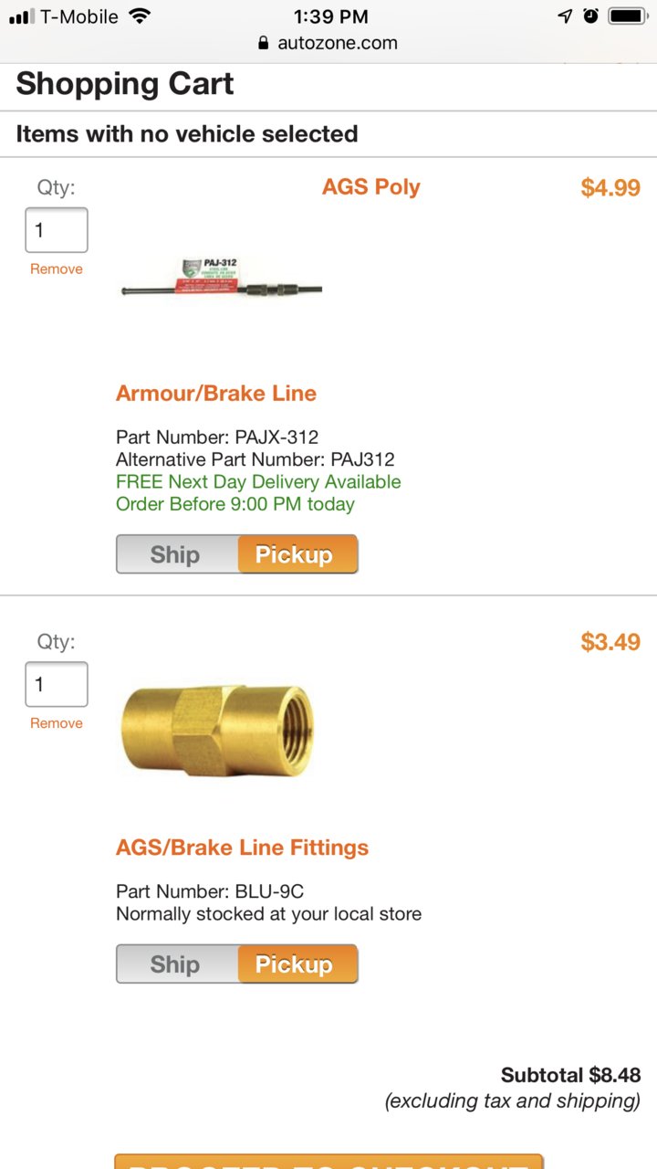

    C27FA3EC-7B42-4138-9488-75AD4C5F7054.jpg If you haven’t done the accumulator delete, I highly recommend doing it. The bucking and hard shifts in 1st and second are gone. You can actually feel what your doing.

    $8.48?! why haven't I done this yet...

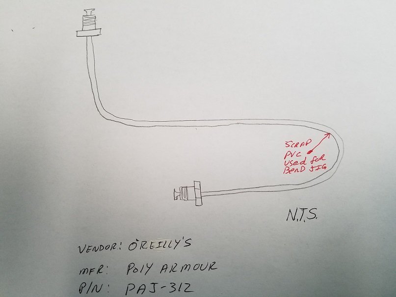

    This is the bend profile. I used the bottom of a Yeti tumbler to shape the bend.

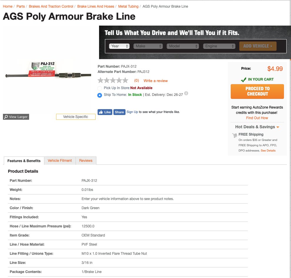

    This should be correct? The part numbers give me multiple parts for some reason. I believe I've got the line wrenches, I'll have to double check.

    It looks like it? The brake and clutch lines are actually 3/16in as listed. The flares are double and M10x1.0.
