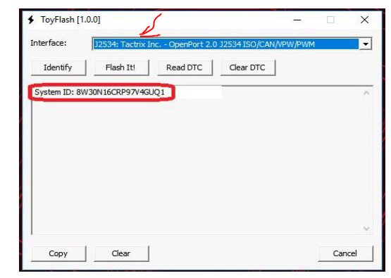

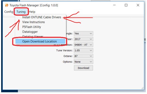

    All right everyone, I emailed @OVTune But its honestly super annoying that every response is going to take several days.
    Edit - ovtune replied fast, my apologies
    I am getting an error message that the dongle cannot be found, and to make sure I have updated the drivers. I see several people having issues but no real solution. Anyone know how to fix?

    Do you have the Tactrix selected:
    If it is not available in the dropdown, did you install the drivers?

    there is no more dongle.
    be sure you go into your windows defender and antivirus and make the exception so it doesn't immediately shut things down "defending" your computer.
