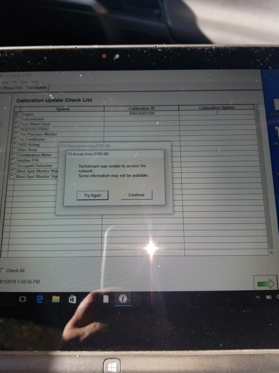

    Finally trying to update my ecu from 04b12. Got connected but when trying to update, I get an s700-08 error "techstream unable to access network". Nothing wrong with my connection.
    Anyone come across this? I'm at a loss.

    I believe that means that TS is trying to get to the official Toyota Information System. You don't want that.
    In reality, you don't even need to boot up TS, just get it installed so that the CUW files become executable. Check the 1st Post here:

    Yeah I believe it was the version of ts I had. Now it's telling me an update is mandatory. I'll try this. Much appreciated!

    If you are getting the mandatory update message, close TS, disconnect from the internet, and open it again. It should give you a warning about 28 days until it stops working or some other nonsense. Click through and it should open normally. If you need to use it after 28 days again, just open TS while online, cancel the mandatory update message and disconnect from the internet again. It *should* reset the 28 day counter.
    Also, I believe you do need to run TS at least once to set the interface to use the Tactrix adapter. I don't think the CUW has a way to select it, at least not in my version.

    So I removed the version I had and installed the one tonered suggested. Still got the update prompt. Did what you said and was able to log on. Buuuut I'm still getting the unable to access the network message when trying to update my ecu:annoyed:

    Open Techstream
    Top of the scren:
    Setup > VIM Select
    Select Openport 2.0 from the dropdown.

    I have the tactrix selected already, so I don't think it's related

    Ahh, ok. Can you post a screenshot?

    That's normal. You don't have a subscription so you can't get to their servers to download anything. You can't download the updates in Techstream without a subscription.
    Did you download the TSB CUW files? You should only have to double click the file and it will open the update wizard. The files you need are posted here in the forum somewhere. If you don't have them, give me a few minutes to find them if someone doesn't post them before I find them.
