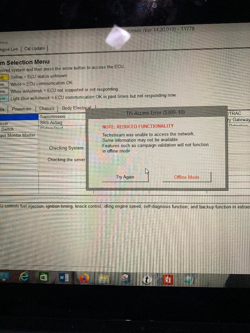

  6. Feb 26, 2020 at 7:46 PM
    Sippi
    Sippi Well-Known Member
    Apr 10, 2010
    #34963
    536
    Boca Raton, Fl
    El Taco Negro - 2017 Sport DC 4x4 6MT
    OVTune 2.0 TC Electronic BHLM 4R Sema with Nitto G2s Swing Case OEM Goodies Pro Items
    I was going through the steps and was presented with this issue. I have interwebby connection.
    CygnusX191 and tonered[QUOTED] like this.

  8. Feb 26, 2020 at 7:51 PM
    tonered
    tonered bartheloni
    Sep 25, 2017
    #231055
    31,337
    tony
    Lynnwood, WA
    That's easy! Don't hit the TiS button. You want to stay offline for diagnostics and monitoring.
    For the TSB tune once you have TS installed, just double click on the CUW file without launching TS.
    Please do follow the tips and cautions in the MT Update thread since the TSB flashes can temporarily brick your ECU.

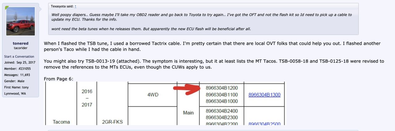

  11. Feb 26, 2020 at 8:12 PM
    tonered
    tonered bartheloni
    Sep 25, 2017
    #231055
    31,337
    tony
    Lynnwood, WA
