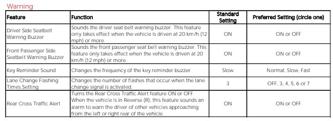

    You have to poke around, but the Customization page says Warnings:
    Good stuff. I am not sure about the model year. You should be able to enter anything? 2TR is the 2.7l. 1GR is the V6.
