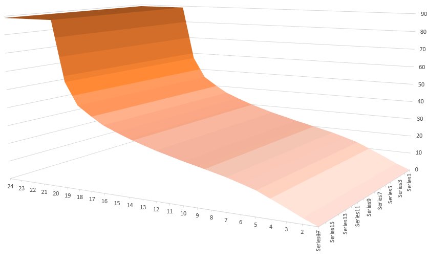

    Nah, i just made the excel file.
    I have this one on a Regular octane, regular file, not SFOB.
    Just note, this is a test file, it only modifies the throttle.
    These are the only 3 maps i changed to do this. Other than these 3, my file is base OVtune
    CORRECTION! - I did remove the throttle limits in first gear
    It behaves different than OVtune's, it is a little flat in the 2-3k range, and require a little more throttle input than Ovtune's (his was crazy aggressive anyways IMO)

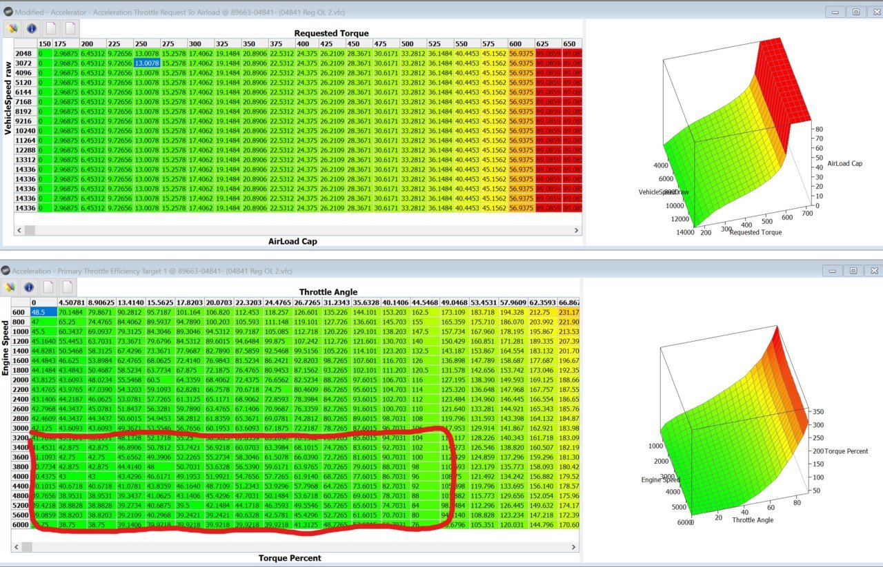

    He only did the 1G map, which is what i'm messing with. I only made like 2 changes to the base Primary map, its at the low range. It helps with that sudden drop off when starting from a stop.
    The Accelerator Request to Airload map is the one that seems to kill the rev hang the most. Im not sure if it created a throttle limit or what, but didnt seem to affect acceleration at all.
    I know if you take that map, and move the curve to the left about 3 cells, it will rev hang on every single shift.

    I tried the ALC stuff, but ended up going back to stock. Once i get rid of the flat spot i was talking about, i will venture back into those, now that Matt has provided some more information on what they do.
    I feel that what ive done, is a band aid of sorts and am also waiting for the stuff from Matt. However, the following changes do more than help with rev hang.
    It stops the thud when getting back on throttle, gives more of a range to the accelerator pedal for more low pedal control.
    The key to stopping it, seems to lie in the values in red, keeping them lower makes it sort of throttle back. But i think it also explains the flatness. But, im still working on it.
    CygnusX191 likes this.

    One quick thing. You're tab for Primary Throttle Efficiency is not the ALC map but the PTTT map, right?
  19. Mar 16, 2021 at 2:04 PM
    tonered
    tonered bartheloni
    Sep 25, 2017
    #231055
    31,336
    tony
    Lynnwood, WA
    Only when I read the posts.
  20. Mar 16, 2021 at 2:24 PM
    92ehatch
    92ehatch Well-Known Member
    Jun 9, 2019
    #295818
    841
    Kinley
    Hendersonville NC
    2019 Cavalry Blue DC TRD OR 6MT
    Yes it is the PTTT Map, it changed names
    its almost 100% stock except for the area in the top left corner. i dropped just a touch right off throttle. I feel that it helps keep the rpms from overshooting when taking off at a stop.
