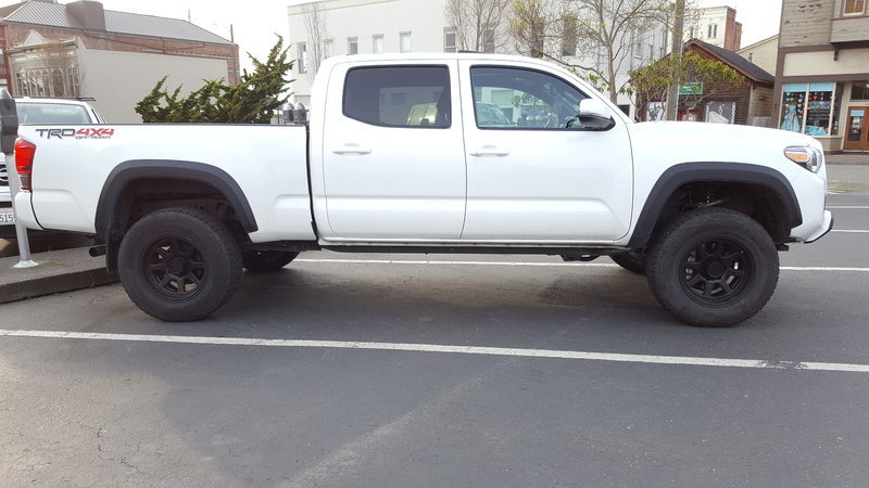

    KMC XD series 17x9 4.5 backspace and -12offset. I was very novice and asked the "pros" to hook it up with wheels that would fit and once they put em on they wouldn't take em back. Complained and made a fuss but they wouldn't budge.
    Rubbed a lot, then moved both 6112's to the top 5th notch and now it doesn't rub. Looking at getting the right wheels and then selling the current ones so in the near future I can throw 285's on.

    Local motorsports shop only charged me an hour and the alignment to adjust. Yeah I was really excited to get a brand new truck and get it set up right and i've had to deal with pain in the ass things. First the "pros" put 285's on and when I went to drive out the parking lot, i turned the steering wheel maybe 2 inches and it rubbed suuuuper hard. Should have got 8 wide instead of 9 and maybe -6 or 0 offset.
    Good news is I sold my stock wheels and tires for 850 which paid for the rims which were 675. Cooper AT3's are my favorite all terrain.
