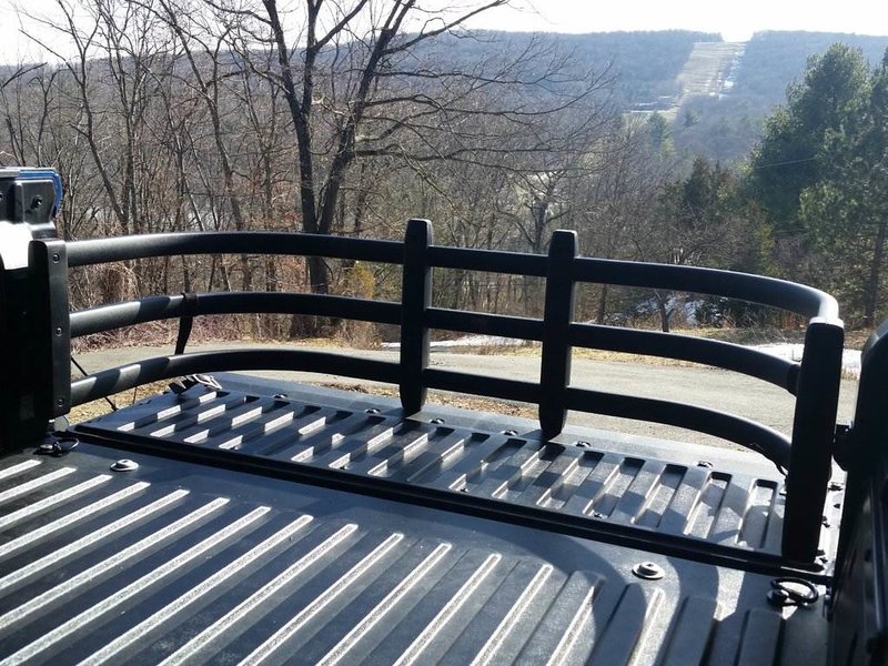

    Looks great! I got the same version, but have not yet installed. Did you have a template to drill the holes?

    Yes, what I did was leveled the bed extender by putting books underneath, (who knew reading would come in handy!) then I slid the template behind the mounting plate, taped the template to the truck, made sure the tailgate would close, and drilled.

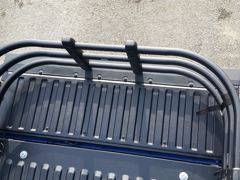

    @axe, if you don't mind, could you take a picture standing in the bed looking straight down at the extender? Also, could you measure from the front of the bed to the center of the extender and let us know the distance?

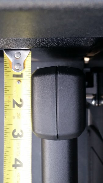

    This is the gap I left between the bed and the extender, you could get it a little closer if you wanted to.Screenshot_2016-02-07-14-46-22.jpg
