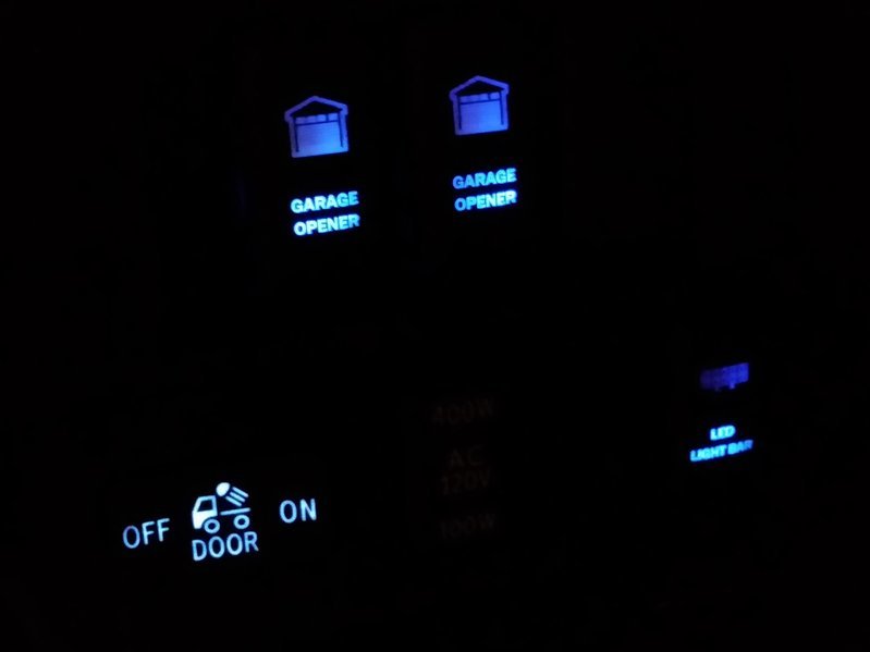

    The cubbie was replaced with this switch panel as seen in this thread
    The switches are momentary switches from AOB (They appear to currently be sold out in Blue)
    For the transmitter, I used my existing garage door opener and soldered wires directly to the PCB per instructions from this thread.
    https://www.tacomaworld.com/threads/no-homelink®-no-problem-first-mod.394920/
    The transmitter is stuck under the dash using velcro.
    I wired the transmitters to my switches using the diagram below. This allows the switch to light up the lower part with dash lights on and light up the top part when you press the button.

    Backlight action shot:

    It's much better suited for a DIY mod since it uses your existing garage door opener. It's super easy (that diagram looks more complicated that its really is), you just need a few parts and remedial soldering skills.
