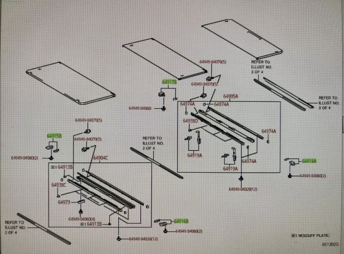

    hi!
    New member here , been lurking for a while :) and I looked at that link and my head went spinning ....hopefully those charts have more clarity on a computer vs a phone !
    But I would still appreciate it if one of you subject matter experts could point out/ reconfirm the part numbers PLEASE for :
    the two filler hinges / screws big and small (plastic things which seem to break )
    And my weather stripping on top of the cover between the hinges is also ripping , I want change all that out and breathe new life into this cover since I transferred it from a 2016 to my 2019
    Edit: list of parts I have compiled(bought)so far . It might make someone else’s life easier in the near future!
    Tonneau cover hinge cap
    :RR 64917-04010
    :RL 64918-04010
    :screws 64949-04080
    :FL 64915-04010
    :FR 64916-04010
    Weather strip
    :64972-04011 rear and middle panel
    :64971-04011 (x2) middle and front panel
    Install: https://www.tacomaworld.com/posts/25454323
    Note: make sure you order the exact parts even the weather strips are different for front and back panels!

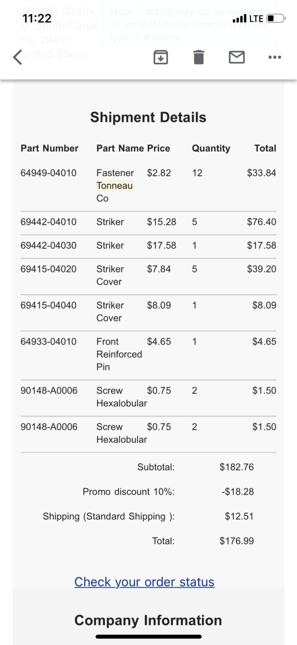

    Your best bet is to just search through and read all the threads on here. It was a while ago but I don’t remember seeing anything about the weatherstripping. If you call up one of the parts distributors like Conicelli Toyota they can help too.
    https://www.tacomaworld.com/threads/tonneau-cover-bolt.476677/
    here’s a pic of the parts I bought
