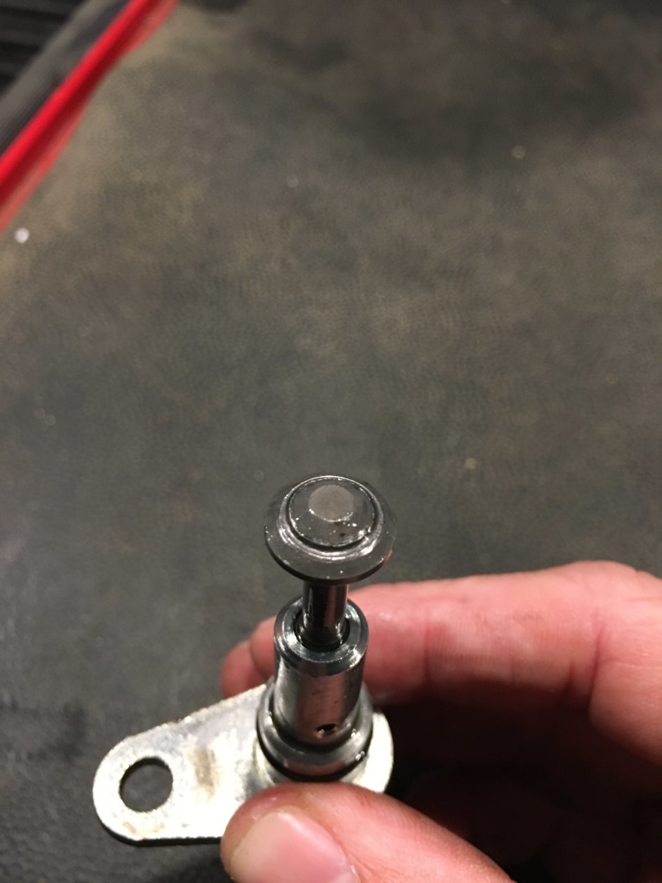

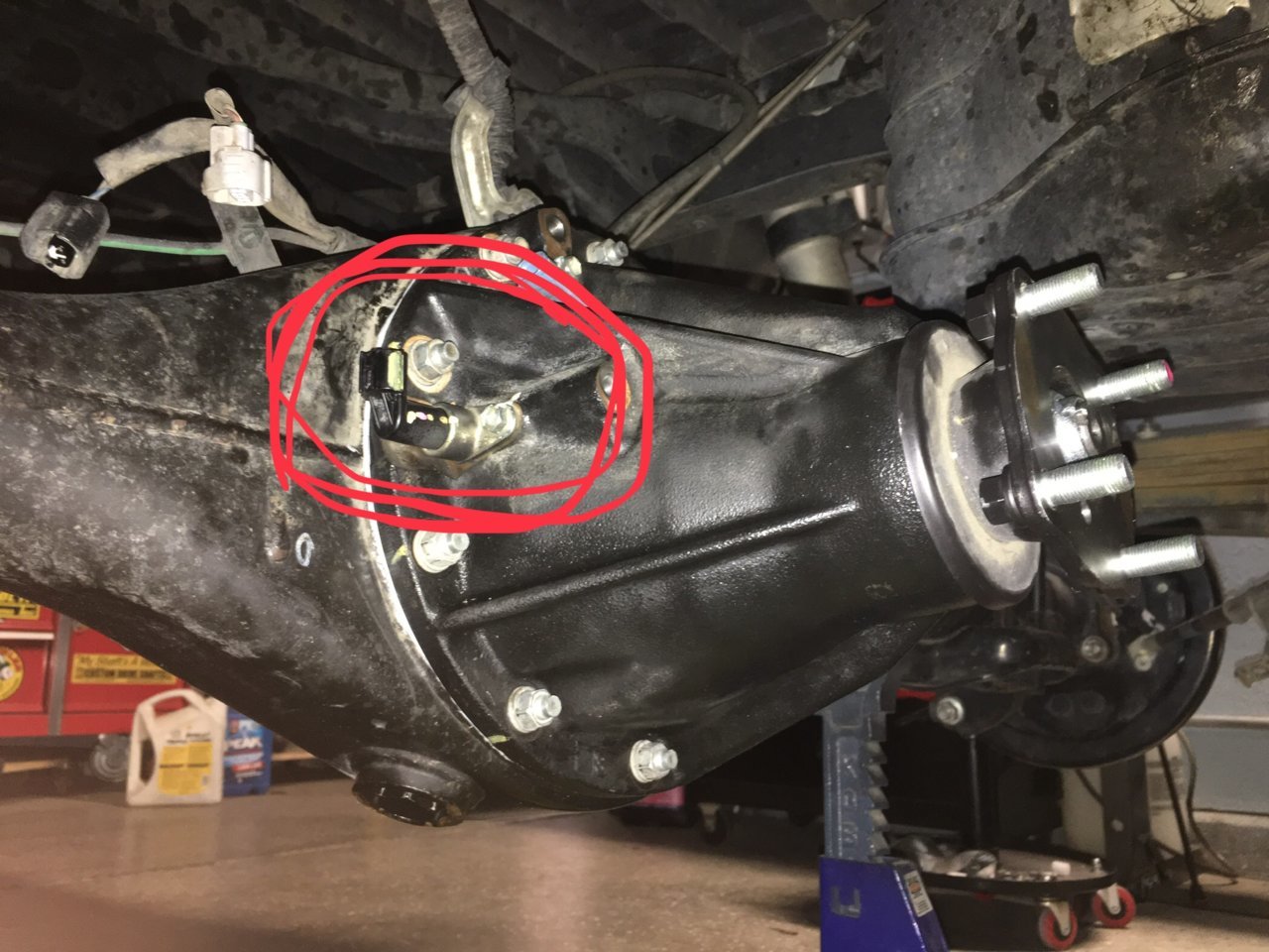

    Our locker system works like an eaton locker. It has a ring that moves back and forth to engage or disengage around the whole center gear. When our locker system engages the ring moves towards the drivers side. This pulls the sensor out and you get your locked light. If the sensor isn't pulled out your locker light just flashes. It looks like a plunger. I imagine since they used a sensor like this that going too fast with it riding against the ring could cause damage.
    We just had 4.88s installed and they installed this sensor AFTER the gears instead of BEFORE the gears. So the plunger pushed the ring out and make the rear end posi. I'll attach of picture of what it did to the plunger when I'm out of the dead zone at work.

    What are we looking at Rus$?

    Normally the flat side of that plunger sits against the locker ring. This one was installed incorrectly. Since this was put in AFTER the gear install it was pushing against the ring. That is the sensor that detects when your elocker is engaged. I circled where it is on the elocker.
