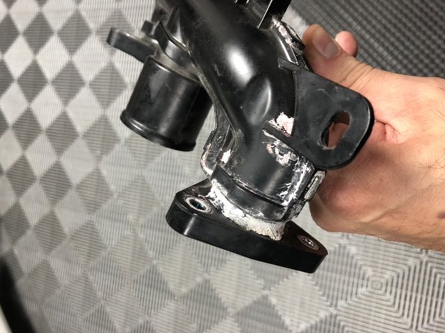

    I had a leak in the back of the engine as well. They had to replace a coolant tube. It had a small crack in it and I had to pay out of pocket which was about $800 something. At the time I had about 37-38k miles on it. I have a 2017 as well.

  5. Jan 25, 2020 at 4:28 PM
    #105
    ShineTech
    ShineTech Active Member
    Oct 25, 2016
    #200689
    35
    2017 Tacoma TRD Off-road

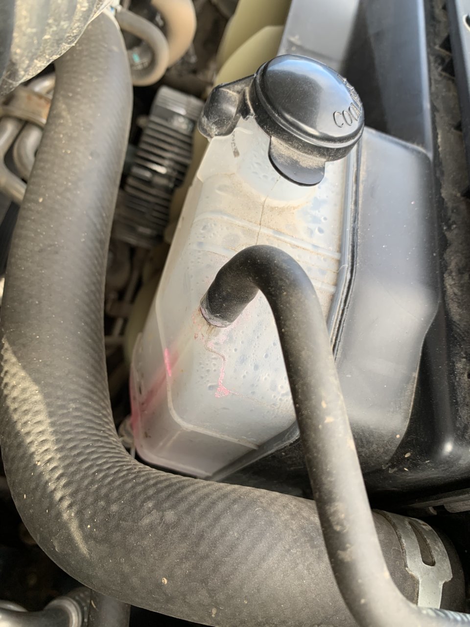

    I’m at 38k miles I just checked the coolant again and it’s definitely LOW, I had been noticing that my coolant level has been noticeably dropping several months back did not realize it had gotten this low. Didn’t see anything else suspect other than the small hose on the top of the reservoir doesn’t have a clamp on either end, I can also see some residual buildup around it
