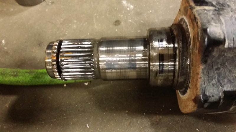

    Yeah my local dealer sucks, totally denied it was happening, then blamed the lift and axle angles. After showing them the angles were nearly identical to a trd pro, they blamed some mud they noticed and said i mustve tweaked something offroad and they wouldnt look into it any further. Service writers attitude changed after i brought him the pos needle bearing in and dumped it on his desk all stinky and nasty and showed him where ir was wearing my axle because of the slop. Such a difference in the tolerance between the ecgs bushing and the needle bearing
    Note the shiny spots where the bearing was
