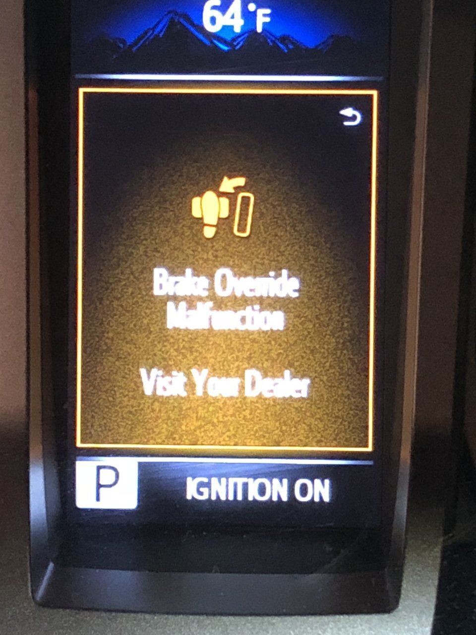

    Oh, well then, brake pedal switch, unplug it and check with your multimeter. Should show open when not applied and have continuity when applied.

    How do you know this? It pops up on the screen saying "apply brake"? Describe what else is happening.
    Really though you probably ain't going to get this problem diagnosed here. You shouldn't have blown a fuse unless something got screwed up. I would recommend taking it to a mechanic you trust or the dealer failing that.

    Wiring diagram? Scan tool? I agree a likely cause is the brake pedal switch signal is not getting to the ECU. We could confirm that with live data or with a test light / multi meter. Much easier to trace wires with a diagram. Pretty sure somebody posted one here.

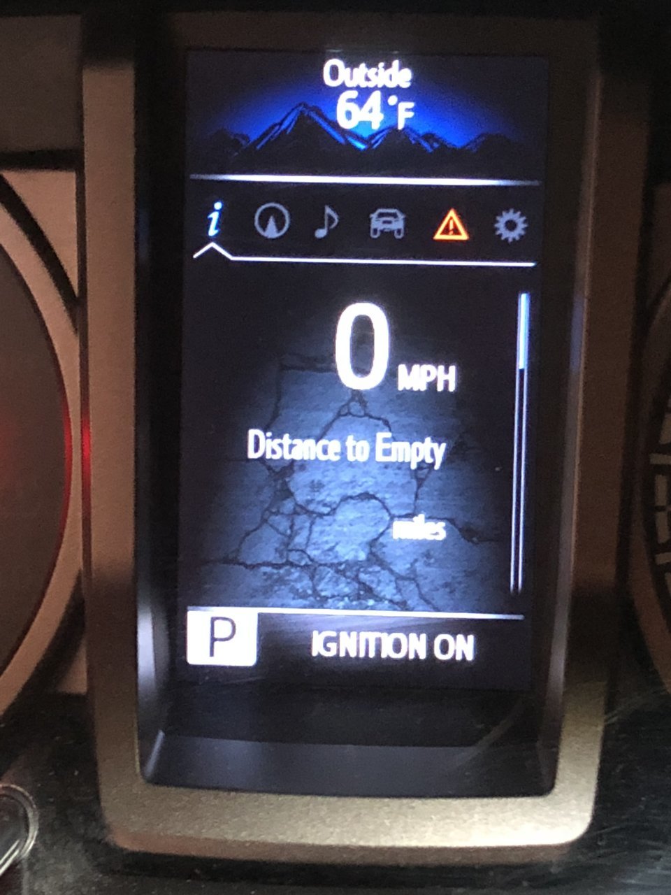

    Lights are assembled. I try to start it and this message comes up

    The car says ignition on. But does not try to crank . Break lights still don’t work

    Do yourself a favor, and look into what you shifted when you moved your bed, and/or find a way to pull codes or some real scan data. See what the cause for override is. Don't just keep guessing. Electrical gremlins are no fun, and easily made worse by using a DMM without knowing how. The smoke capsule inside all vehicle modules is easy to set off.
