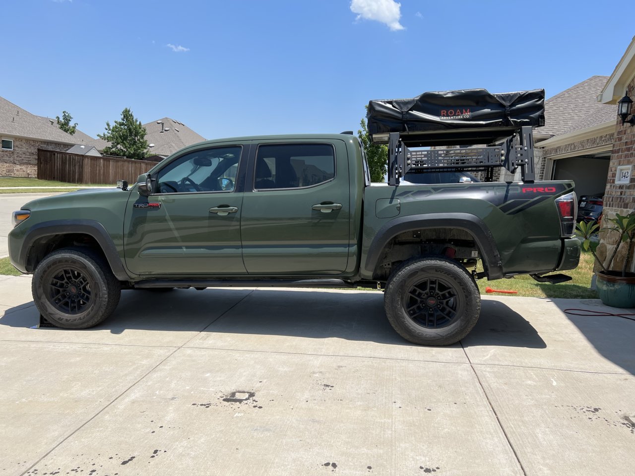

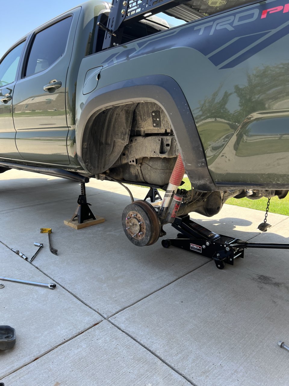

    It has begun

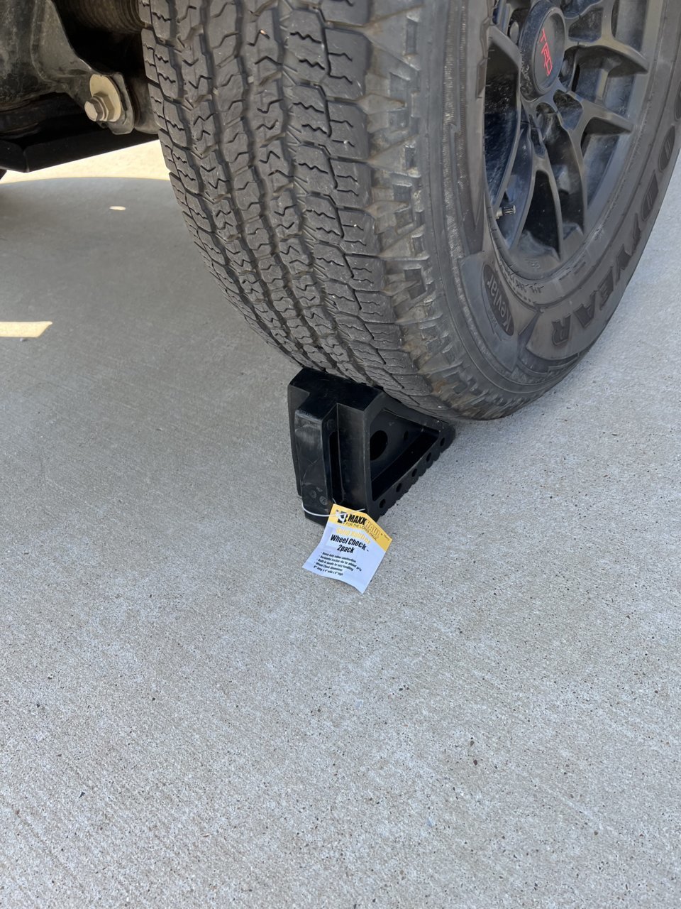

    Yes I’m chocked

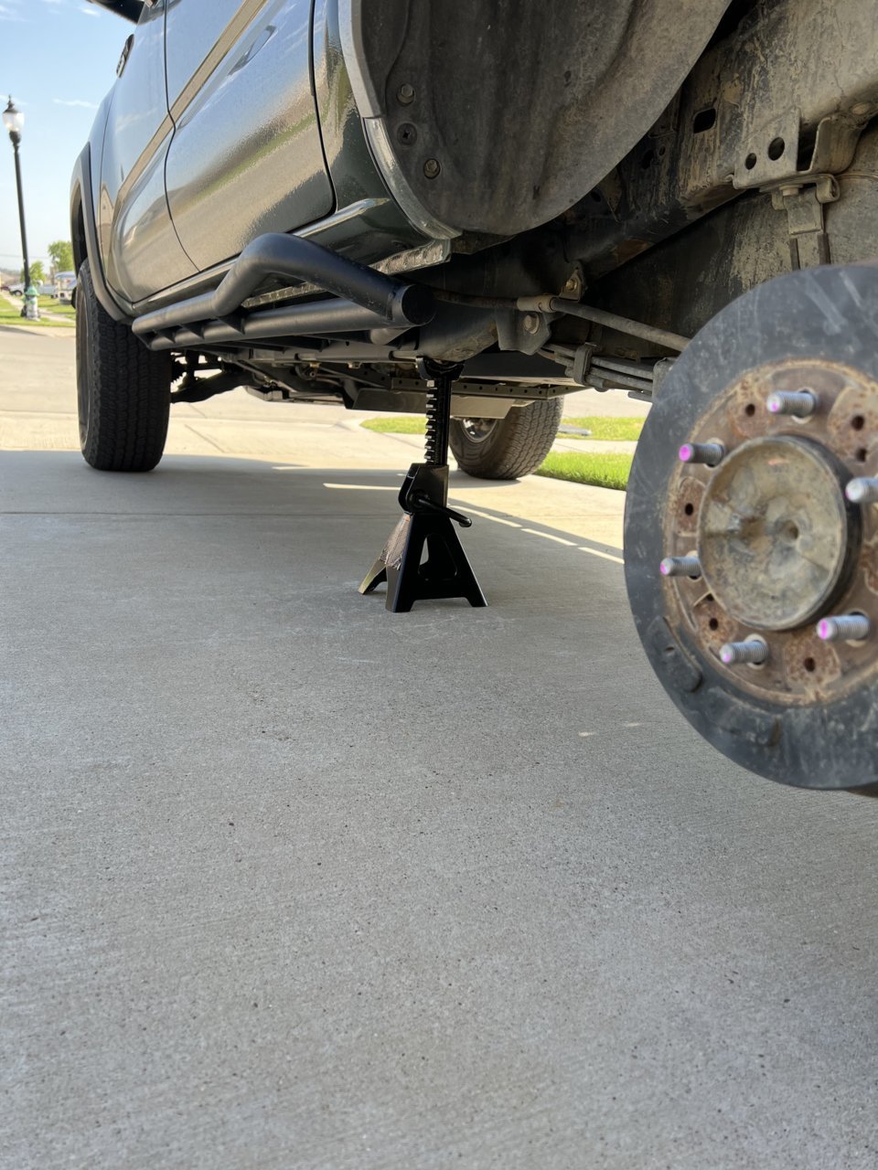

    Full skid plate collection from Cali Raised, Rock Sliders, Overhead Bed Rack, RTT, Decked System, Ditch Lights

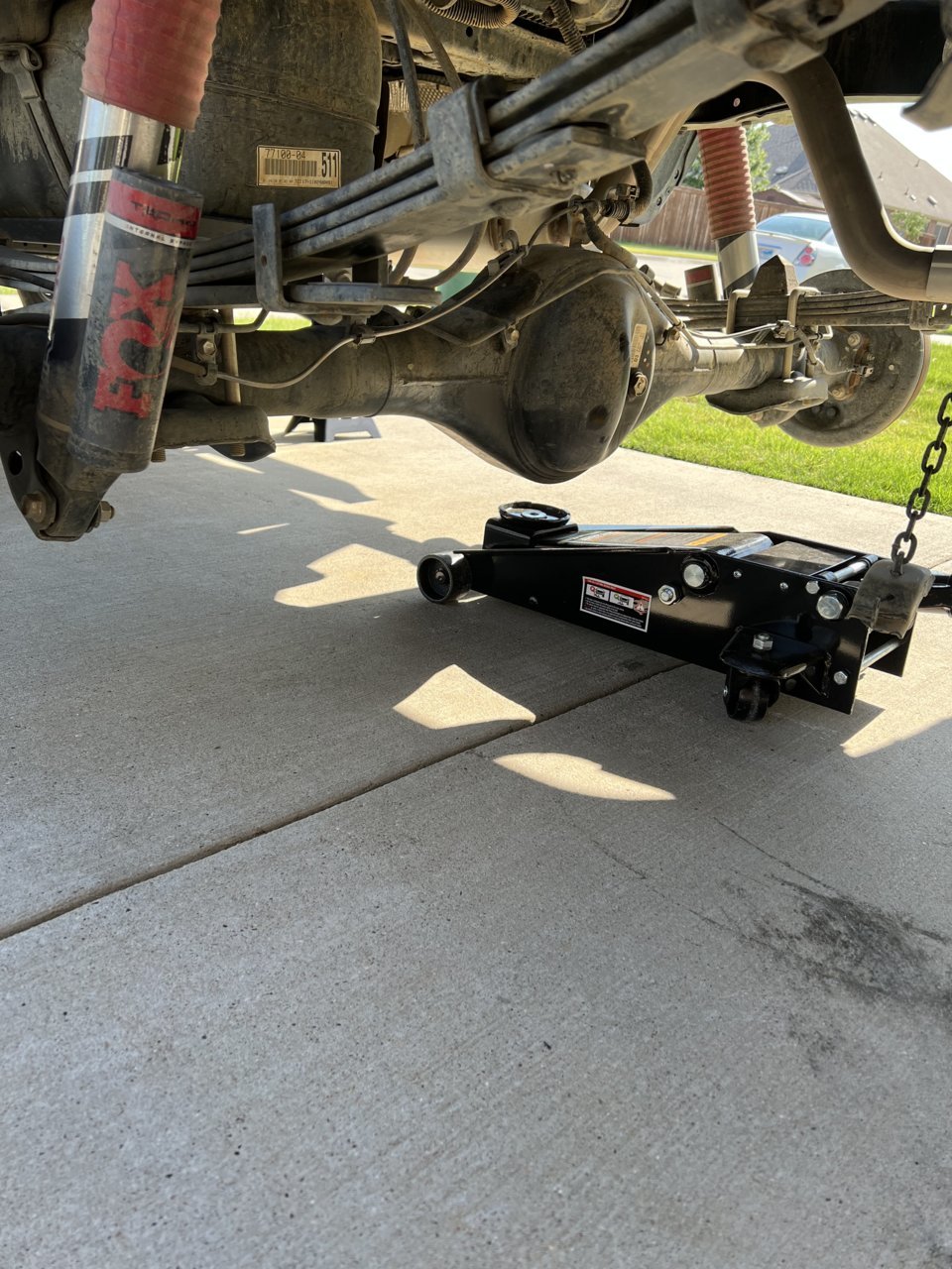

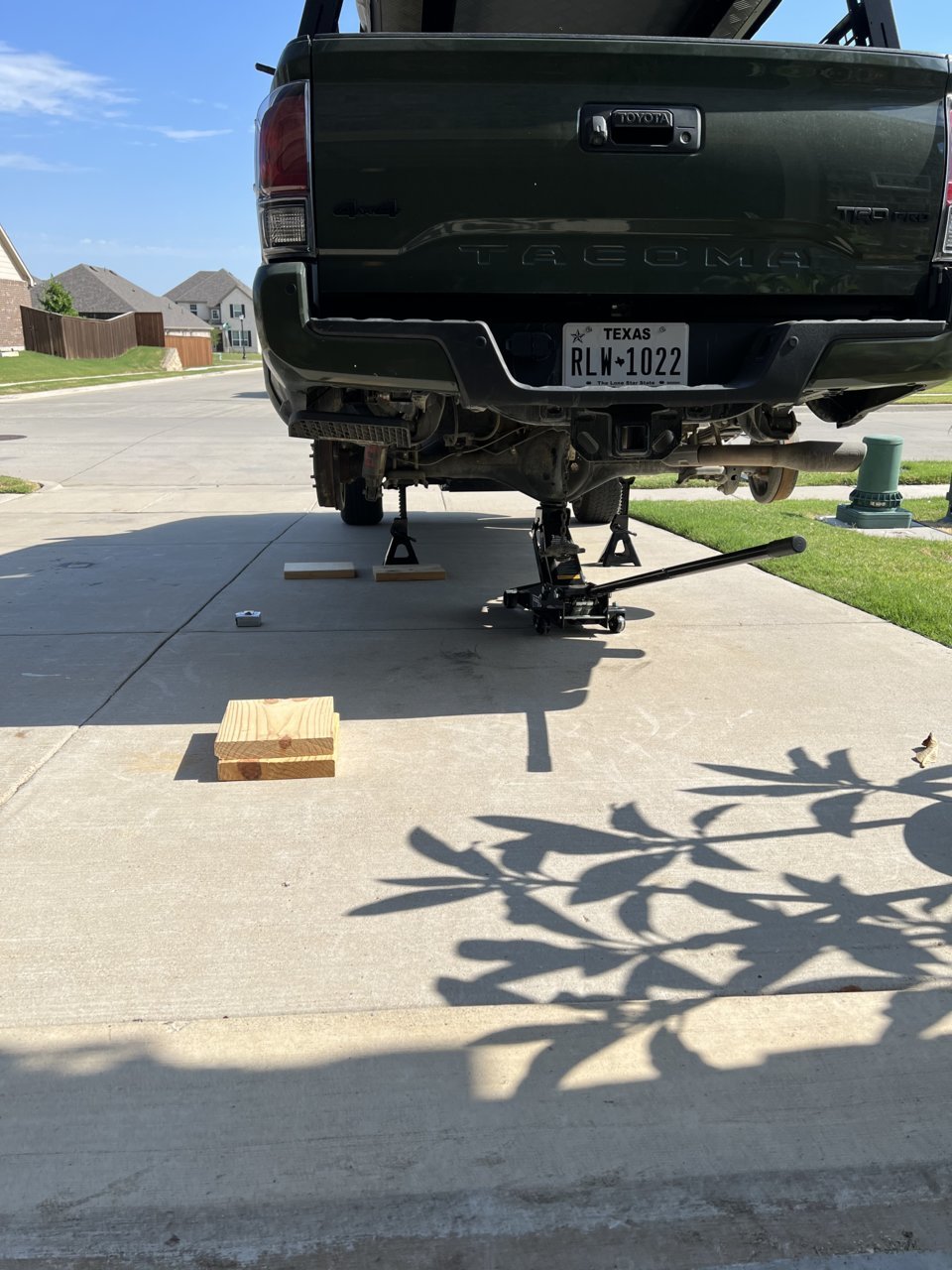

    As quickly as it has begun, I think it has ended…. My rear diff is sitting 1.5 inches away from my bottomed out floor Jack… after the 2 inches of OME lift… how am I gonna get the som’bich back upwards? Safe to put the jack stands on some 2x10 inch boards? I got a bunch of scrap lumber ¯\_(ツ)_/¯
  11. Jun 26, 2022 at 7:45 AM
    #31
    3JOH22A
    3JOH22A トヨタ純正男娼
    Mar 27, 2019
    #288172
    12,688
    District 6ix
    3G Tacoma on 35"s, 5G 4Runner
    Yes it's safe to put jack stands on wood boards. On asphalt driveways, the jackstands would dig into the pavement without boards. Alternatively buy some 6-ton jack stands from your local store - they don't need to be extended as far as 3-ton stands so they're far more stable.
    Replace the leaf pack one side at a time. That way you can put the hydraulic jack under the axle tube near the side you're working on. Loosen but don't remove the U-bolt nuts on the opposite side to give wiggle room.
    This is scary as shit lolololololol but I’m being slow and giving it a structure test every squeeze of the jack

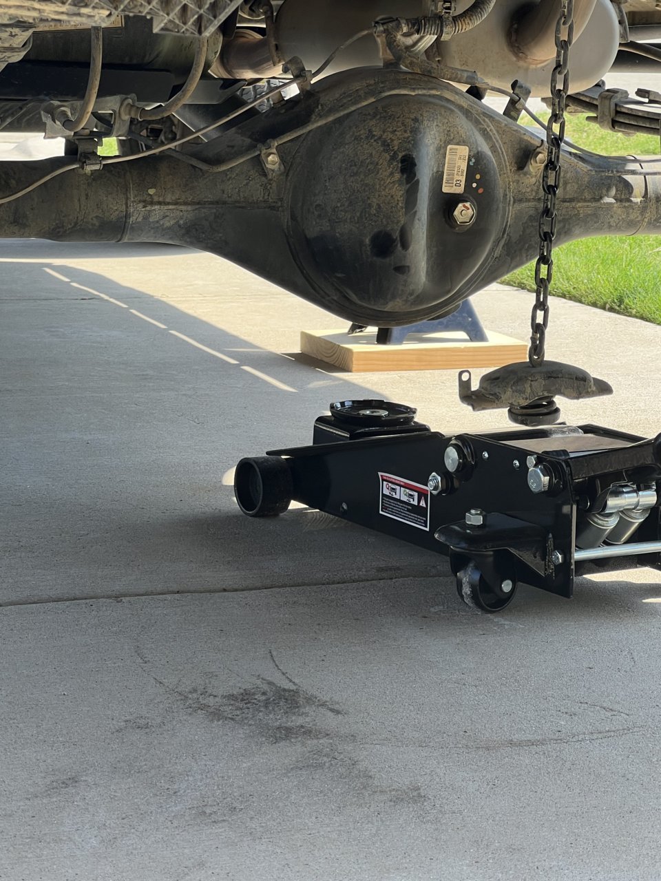

    Yup thanks. I think that’ll do
  14. Jun 26, 2022 at 8:04 AM
    #34
    mutely
    mutely Well-Known Member
    Feb 15, 2017
    #210640
    1,848
    TRD Pro in metallic primer

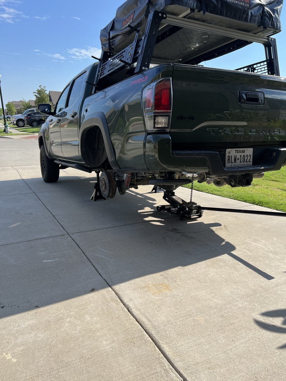

    Probably too late now, but put the wheels back on before you start messing with repositioning jack stands.
    PearBear[QUOTED][OP] likes this.

    noted. Yea…

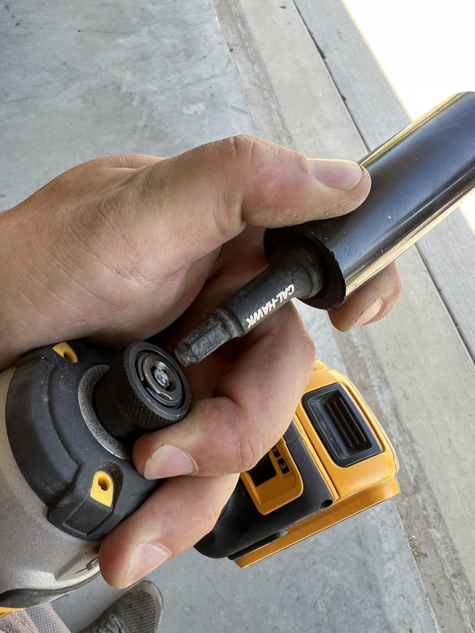

    Lol… gonna have to use my muscles now. Broke my one and only 1/2 inch impact driver

    Update
    3JOH22A likes this.
  18. Jun 26, 2022 at 9:22 AM
    #38
    3JOH22A
    3JOH22A トヨタ純正男娼
    Mar 27, 2019
    #288172
    12,688
    District 6ix
    The bolt attaching the leaf shackle to the frame is very tight. It wouldn't budge with my 3/8" drive impact (250 ft-lbs). I had to use a 24" breaker bar there.

    Yup had to borrow my neighbors breaker bar
