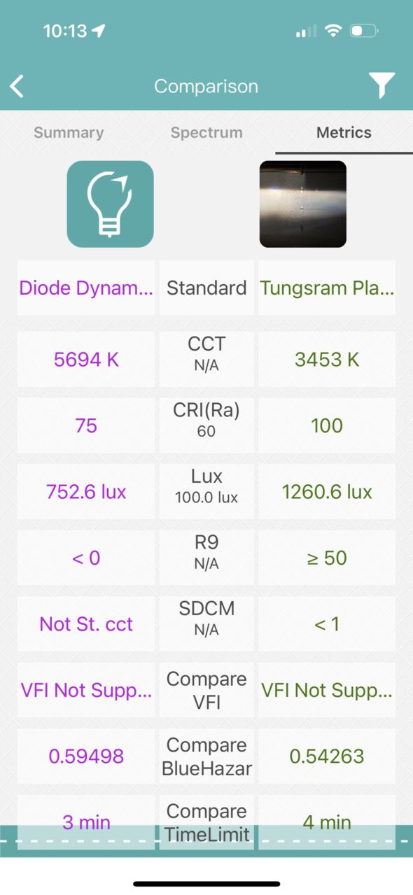

    Diode Dynamics SL1 LEDs are obsolete, you are living in the past if you claim that product has come a long way. Even Diode Dynamics has abandoned product development on replacement LEDs. And the GE +130s are also pretty dated as a comparison point, Tungsram bought out the GE lighting division and now the Tungsram Platinums are the best performing H11.
    Diode Dynamics SL1 vs Tungsram platinum
    The highest performance H11 halogens have 67% higher output intensity than the SL1 (H9 swaps are even higher). Basic headlight optics, the Tungsram has vastly superior focus leading to significantly enhanced output that a poorly focused product like the SL1 could never hope to match. Instead the poor focus of the SL1 shifts the light pattern to foreground light and loss of distance light limiting the ability to see distance while also making the driver believe they can see better since people judge light output based on the foreground light. Halogens on the other hand work correctly with the headlight optics they were designed for and minimize the foreground light while increasing hotspot intensity to significantly extend distance projection. The best overall is to go for OEM LED, which has the optics designed around the LED light source and outperforms all other options. If set on a replacement LED, the correct option is to go with the Morimoto 2stroke 3.0s which are far more advanced and focused than the dated Diode Dynamics units.
    Reviews with data:
    Diode Dynamics SL1 review posted here.
    The only recommended replacement LED, the Morimoto 2stroke 3.0s covered here (light years more advanced than Diode Dynamics).
    The only correct way to run LEDs covered with the OEM LED assemblies covered in post #3626 here.
    Tungsram platinums that easily beat out all replacement LEDs covered here: Tungsram Platinum.

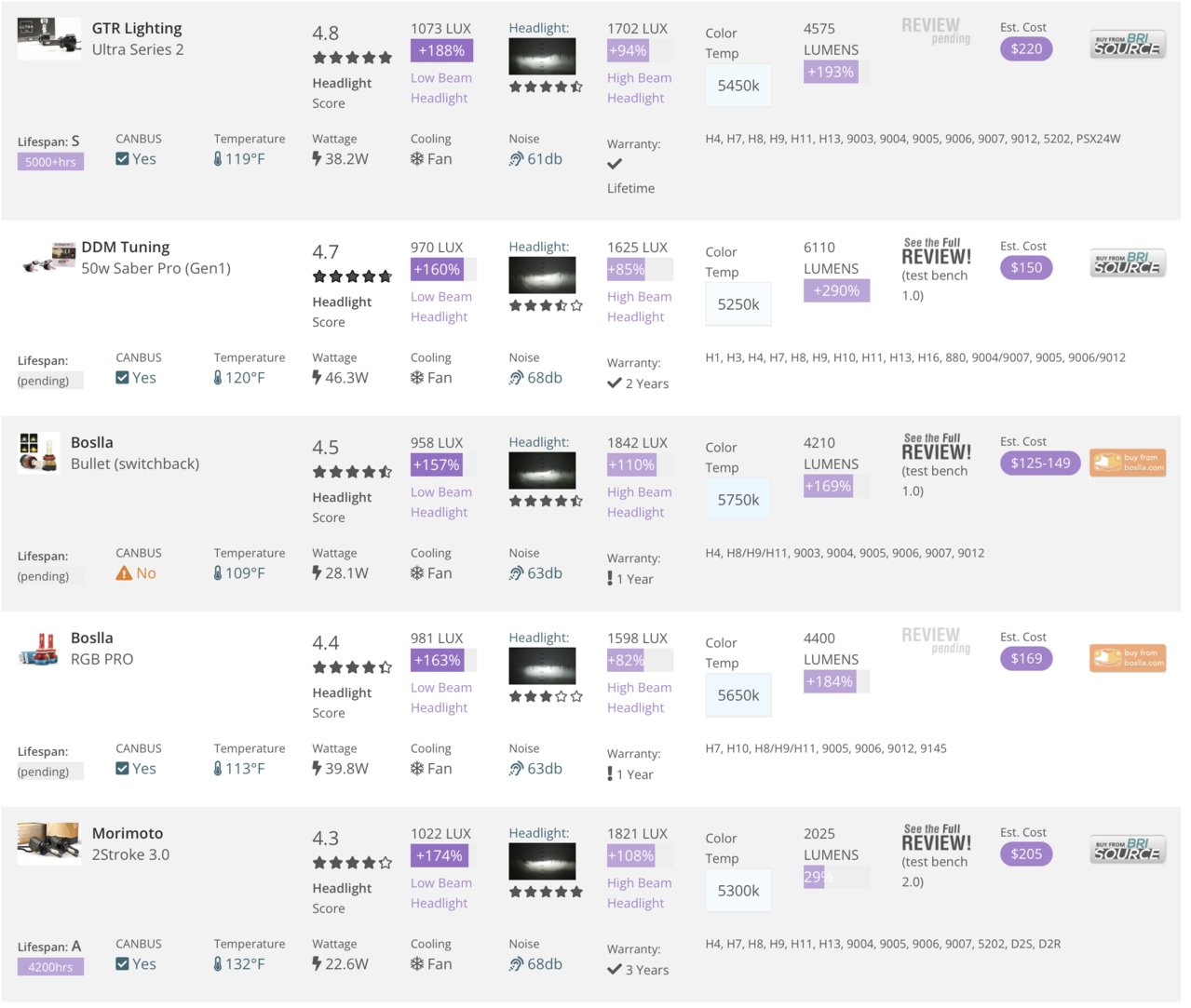

    Always great to cultivate multiple sources for info. However, you'll note that the #1 product recommended in the video doesn't replicate a halogen at all, it is a dated LED design to prioritize output over focus, which leads to a poor headlight pattern that looks great in videos as it is brighter near the camera. And funny how that carries through their recommendations.
    To really drive home how flawed that site is, they literally recommend one of the worst LEDs in this thread, the GTRs, significantly over the best LEDs on the market as recognized by industry experts, the Morimoto 2 stroke 3.0s. No legitimate lighting expert could say this with a straight face. Somebody is not an optics or lighting expert at all and likely basing results on short range tests that conceal the lack of focus.
    Worst LED in the thread: GTR Ultra Series 2 in post #2816 here.
    Best LED in the thread: Morimoto 2 stroke 3.0 in post #4548 here.
    Weird how the ranking is inverted in bulb facts.
    Also note that Blubfacts is paid by sponsored clicks, or affiliate links, aka clicking on a recommended product earns them money. Some brands offer better rates for clicks than others to be promoted higher up in rankings. There is at least one brand in their top list that is very aggressive about product promotion that was banned from this site.
