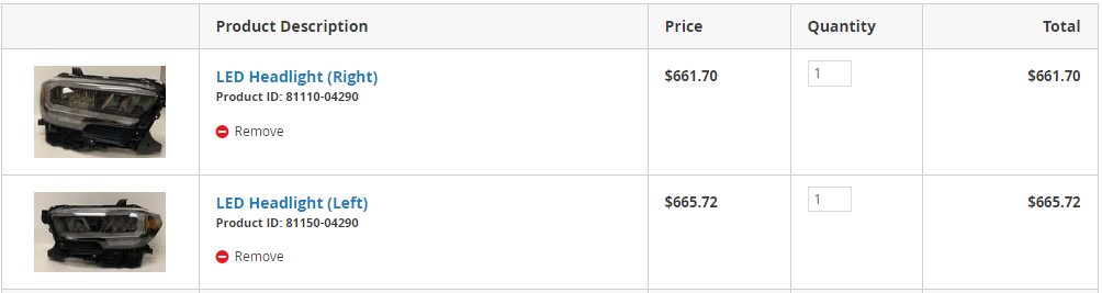

    Excellent, that is what I had picked out. Just one last sanity check:
    These + harness above is what I have on my list. Anything else I need to make this happen?
    Greatly appreciate the help!

    I went ahead and placed an order for the harness just to have that at hand. Will do some shopping around locally here to see if I can find those housings for a better deal.

    You’re fine. Proceed. I have your harness boxed up and will send today. You just have to decide pro or non pro headlights. I’d buy from a dealership but you could see if any sales happen over Memorial Day or July 4th

    Cheers! I have reached out to my original dealer and shopping around locally here. Out of curiosity, what is a ballpark price for the pair? I am seeing $900-$1200 range so far. Unless there are significant savings to be had, I may just proceed with Sparks (SC dealer).

    Prez day 2022 was the best pricing I’ve seen, they were eligible for the discount and many got the pair for under 1200
    I paid nearly 1400 for mine.
    sparks with Chloe Kuo discount code is a safe bet. They are pretty good about proper packing. Other dealerships seem to be hit or miss on packing and the wrong day at UPS means you’re stuck dealing with a broken tab return.
    your local dealer may be close on price and that route is way safer as they are part of the parts supply stream rather than shipped individually with a third party.

    Thanks for the info and that discount code. Soon as I am done with my gauntlet of work meetings I am calling Leith and seeing what they have for me.
    Sounds to me that the $1200 price is reasonable but I will see if I can get it locally and avoid the shipping pitfalls. I know too damn well how fun that can be.
    EDIT: Leith quoted me $700 per side, they don't have them in stock and will need to be shipped to them or to me. I am more than likely going to settle for Sparks + Discount code. Total comes to just over $1,300.
