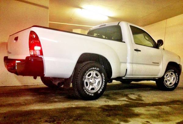

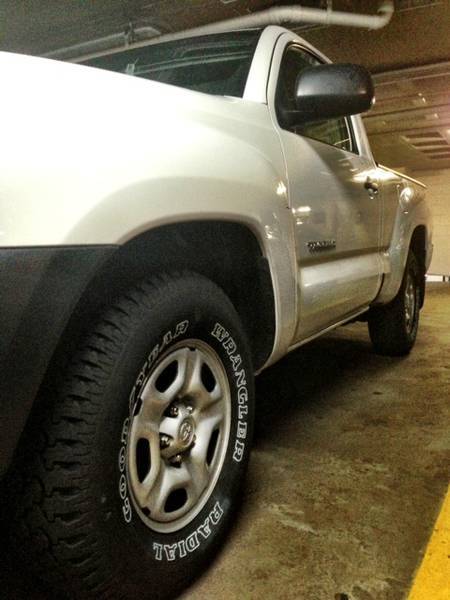

  8. May 30, 2013 at 5:51 AM
    jtye
    jtye Well-Known Member
    May 17, 2013
    #104339
    194
    John
    DC
    08 Super White 5 lug
    Fog lights, fatbob's 5lug lift, Cragar 15x7, 31x10.5 Gen.Grabbers, Wet Okole
    Pretty much the same, nicer ride though. Honestly, I just couldnt stand how tiny the tires looking with the 215
    here it is from behind
