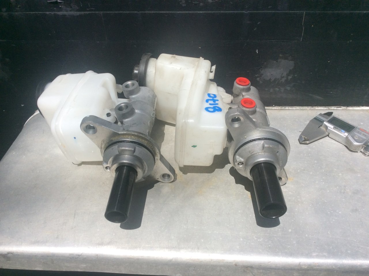

    The stock master cylinder is 20.64mm.
    The one in this thread is 23.81mm.
    The size of the master cylinder doesn't have much to do with it being drums or discs and everything to do with the way the rest of the system was designed. All else being equal, a larger master cylinder will increase pedal effort and reduce pedal stroke, nothing else.
    As far as proportioning goes, from what I can recall, it is handled separately from the master cylinder hydraulics in the Tacoma and the Camry, so the rear brake type (drum/disc) would be unaffected if one did such a swap.
    Changing out the other braking components can very well mean that a master cylinder swap is a good option, it really depends on what you're doing.

    This unit bolts up. Just need to swap the reservoir. Jeff has the correct diameters above.
