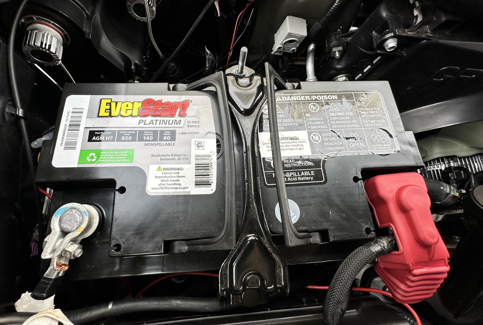

    H7, did not need to change the tray. I did modify the bracket a bit. 4 year free replacement. Use a battery tender to top off your AGM once a month. Make sure to set it to AGM mode. Don’t change the charging output on the trucks alternator, not good to ecu voltage regulators.
