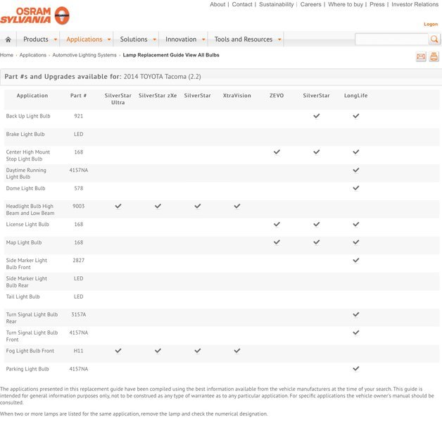

    I think with incandescent bulbs the 2825 is standard color and the 2827 is amber. Specs of the two bulbs are the same.
    According to the sylvania and Philips bulb guides, our 2014 Tacos take a 2827 incandescant (which follows the formentioned convention, as well as our manuals).
    There IS a difference between a 168 and 194 in intensity (wattage) in incandescant bulbs. I'm not sure which of the two is equal in spec to the 2825/2827, although the bases of all the bulbs are the same.
