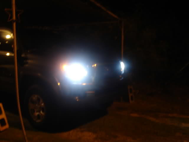

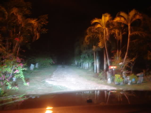

    HID
    1. What are HIDs?
    The best way to describe an HID head light is to compare it to a more conventional halogen headlight. A halogen bulb consists of a wire filament surrounded by an inert gas. When electrical current is applied to the filament, it glows brightly to produce light. Contrast that with an HID bulb which has no filament, but instead consists of xenon gas, mercury, and metal halide salts. The xenon gas is ignited by an arc of high-voltage current and glows brightly. Also, the high voltage is supplied by a ballast, so in these respects it is like a fluorescent light. HIDs are original equipment generally found on luxury and exotic cars but are progressively finding their way into the mainstream.
    2. Why install HIDs?
    If chosen properly, the improved light output of HIDs will give you a better field of vision and thus improved safety. Plus, let us admit it, they look cool.
    3. What is meant by color temperature?
    The Kelvin (K) is the unit of color temperature. 4100K is the brightest, most natural white light similar to that of daytime sunlight, and therefore the HID color temperature used most in the OEM automotive industry. When you look at the light coming directly out of an HID headlight, it possesses a bit of a blue or purple hue which most people recognize as the expensive, elegant look characteristic of HIDs. For this reason, some HID kit manufacturers produce 5400K, 6500K, 8000K, etc. bulbs that give an even more distinct blue hue but at the expense of overall light output. For comparison, most halogen headlights have a color temperature around 3200K which gives them a yellowish appearance compared to HIDs.
    Blue light is more fatiguing to the eyes, both to oncoming traffic and to the driver. Oncoming cars will see your lights for only a brief time, but as the driver, you must deal with it for the duration of your drive. The bluer the tint cast on the road and surrounding area, the more quickly your eyes become tired. It is a personal choice and I recognize and respect that some install HIDs mostly for the look. However, very blue headlights might get you the wrong kind of attention from law enforcement. Personally, I would like to benefit from my investment in the way of increased visibility and safety. Be aware that most of the 6500K and higher bulbs are produced by inferior manufacturers to capitalize on the maketability of "the bigger number must be better". Their 8000K bulbs may not measure 8000K. Do not be fooled.

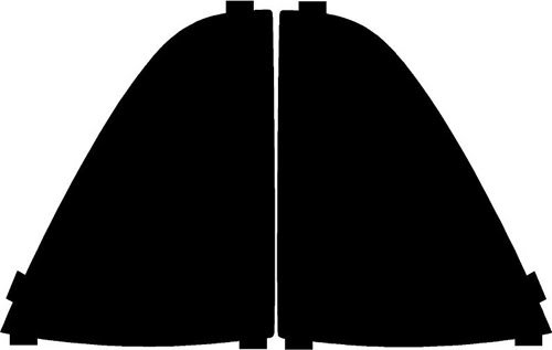

    TAIL LIGHTS
    Just like head lights, there are many after market options for our tail lights. Be it an addition to your stock ones or new assemblies. Here are a few options.
    ***I am not saying it is O.K. to tint your tail lights. Please do so with care and do not go too dark. Some areas will be enforced more than others.***
    Tint Film:
    They come in different percentages of darkness. They will take a professional vinyl applicator or a lot of patience to install. If you ever need to remove them, they peel right off. eBay would be the best place to find these.
    VHT Nite-Shades:
    This spray tint comes in an aerosol can and can just be sprayed on. I have seen many people use this product on their tail lights on the road. They usually come out flat or dull. If sprayed correctly, they can come out glossy. You don't really need to add clear coat afterwards. But, if you would like a more glossy finish, some clear would not hurt it.
    A link to the DIY: http://www.tacomaworld.com/forum/lighting/84694-how-tinting-tail-lights-right-way-pics.html
    Pactra Window Tint
    This spray tint is very similar to the VHT Nite-Shades, but comes in a much smaller can. It is designed to tint the windows on small R/C toys. For light tint, 1 can is enough. For a very dark outcome, I would recommend 2 cans. These come out extremely glossy if sprayed correctly. The only downside to these is that they fade after 3-4 months (depending if you park in a garage most of the time or out in the sun). To prevent the fading, just spray some clear. These can be found at any online/in-store hobby store.
    Covers
    AVS makes acrylic covers for our trucks. You can just velcro stick these to your stock tail lights and remove whenever you would like. They reduce your tail lights visibility by a lot and only come in one percentage of darkness.
    Car Paint
    This is the way I would ultimately recommend to do it. You can either take it to a body/paint shop to have it done. Basically, you mix clear with black. I have consistently used this mixture, 20% black and 80% clear. Some use 10% black and 90% clear. To achieve a darker tint, just spray on more coats until desired darkness. This gives you the best outcome because it is very glossy, and lasts much longer because you can wax it. A typical shop will charge anywhere from $50-$100. If you know a friend, it may be cheaper ;).

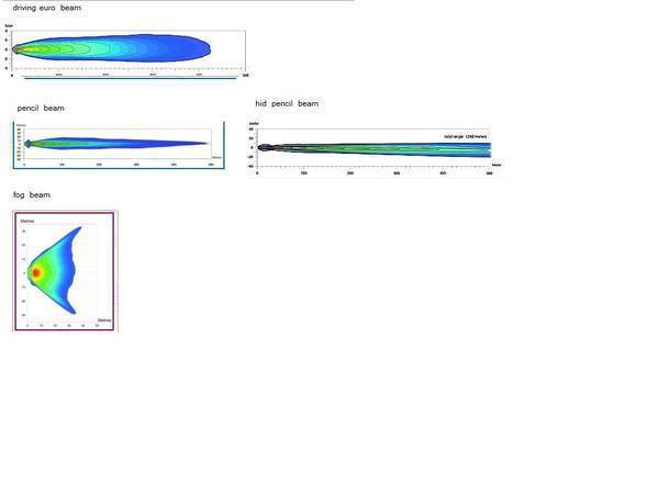

    LIGHT BARS
    N-Fab
    Avid Off-Road
    Westin Bull Bar
    Aries Bull Bar
    WILL ADD MORE INFO LATER.

    i installed 6k 35w hids today. my harness were actually two separate harnesses, each one had its own fuse and relay..is that normal? also on the box its marked hi/low bi xenon but high beams dont work. it clicks but stays at low beam..or which i think is low beam..these are pretty bright.
    why doesnt it work? or is it possible that its just a regular xenon hid because it says on the box. help.
    some pics. it lights up my whole road

    do you have them installed upside down maybe? the metal sheild should be facing down with the opening at the top
