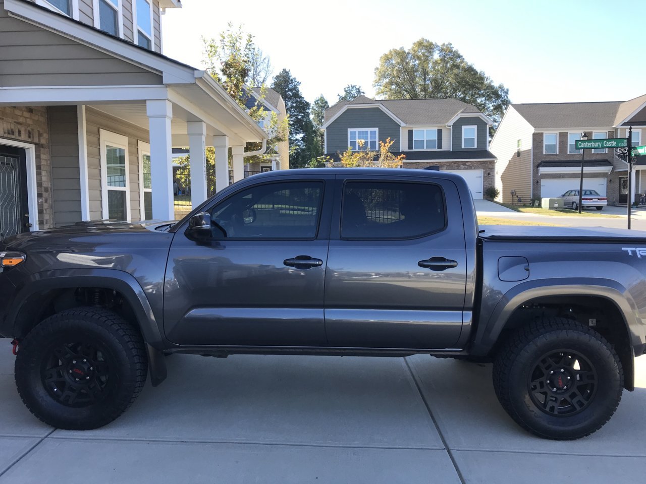

  8. Nov 21, 2020 at 12:02 PM
    #28
    MGMSteelCurtain
    MGMSteelCurtain [OP] Active Member
    Jul 10, 2020
    #334018
    34
    2018 TRD Sport MT DCSB
    Thanks again for all the input! I ended up getting it done. Absolutely no rubbing and no CMC. All about the offset!
  9. Nov 21, 2020 at 12:55 PM
    #29
    GrundleJuice
    GrundleJuice Well-Known Member
    Mar 15, 2015
    #150931
    2,343
    Michigan
    2016 TRD Bro
    [S]Un-Molested[/S] Lightly Molested
    Those are 265/70R17 on the factory trd 7" wheel?

  11. May 10, 2021 at 1:40 PM
    #31
    escapethewormhole
    escapethewormhole Member
    Jan 29, 2021
    #354387
    23
    Edmonton, Alberta
    Can someone advise if I can fit the 285/70R17 on the factory '21 TRD Sport wheel without rubbing the LCA, etc? I know I'll need a cab mount chop if I plan to cycle the suspension offroad or whatever.
  12. May 10, 2021 at 3:22 PM
    #32
    GrundleJuice
    Mar 15, 2015
    #150931
    2,343
    Michigan
    2016 TRD Bro
    I can advise that a 285 tire will certainly interfere with the UCA, not sure about the lower. The 275's I had required the TRD pro 4 runner wheels (or others with similar dimensions) to clear the factory UCA.
