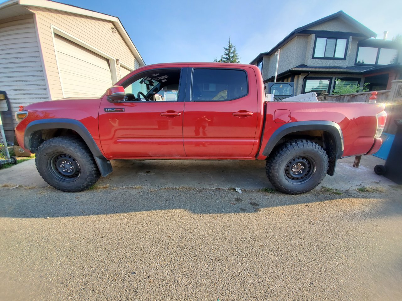

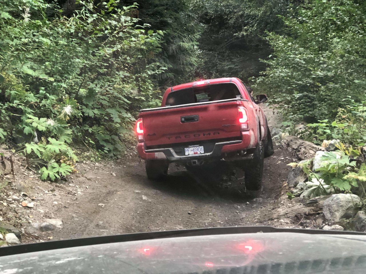

    I have BFG KM2's on at the moment and will be getting some toyo open county MT's as my next set. I have done a fair amount of offroading with some wheel lift and flexing and have not had any rubbing

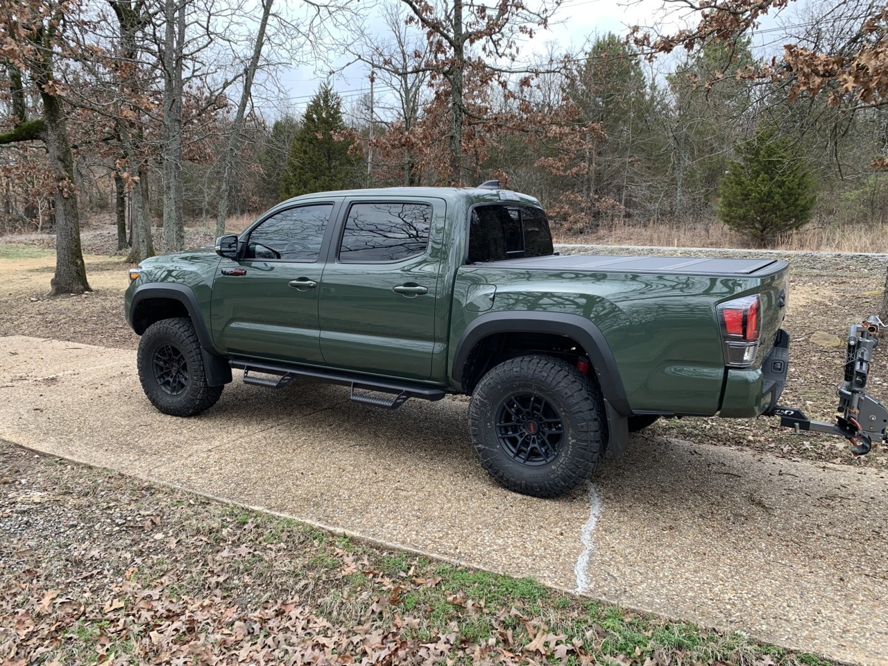

    I have a 2020 trd pro with 285/75/R16 and stock wheels. I’m running Nitto ridge grapplers. I had some rubbing in the rear of the wheel well on the mud flaps. Rubbing occurred in slow speed while turning towards full lock. I used a heat gun on the flaps and made it better. So then I put a 2.5 in spacer lift and new UCA’s. I thought this would fix the rubbing as well as give the tire size a more proportional look. I love the look but it actually made the rubbing a little worse. Now I just ignore the occasional rubbing.

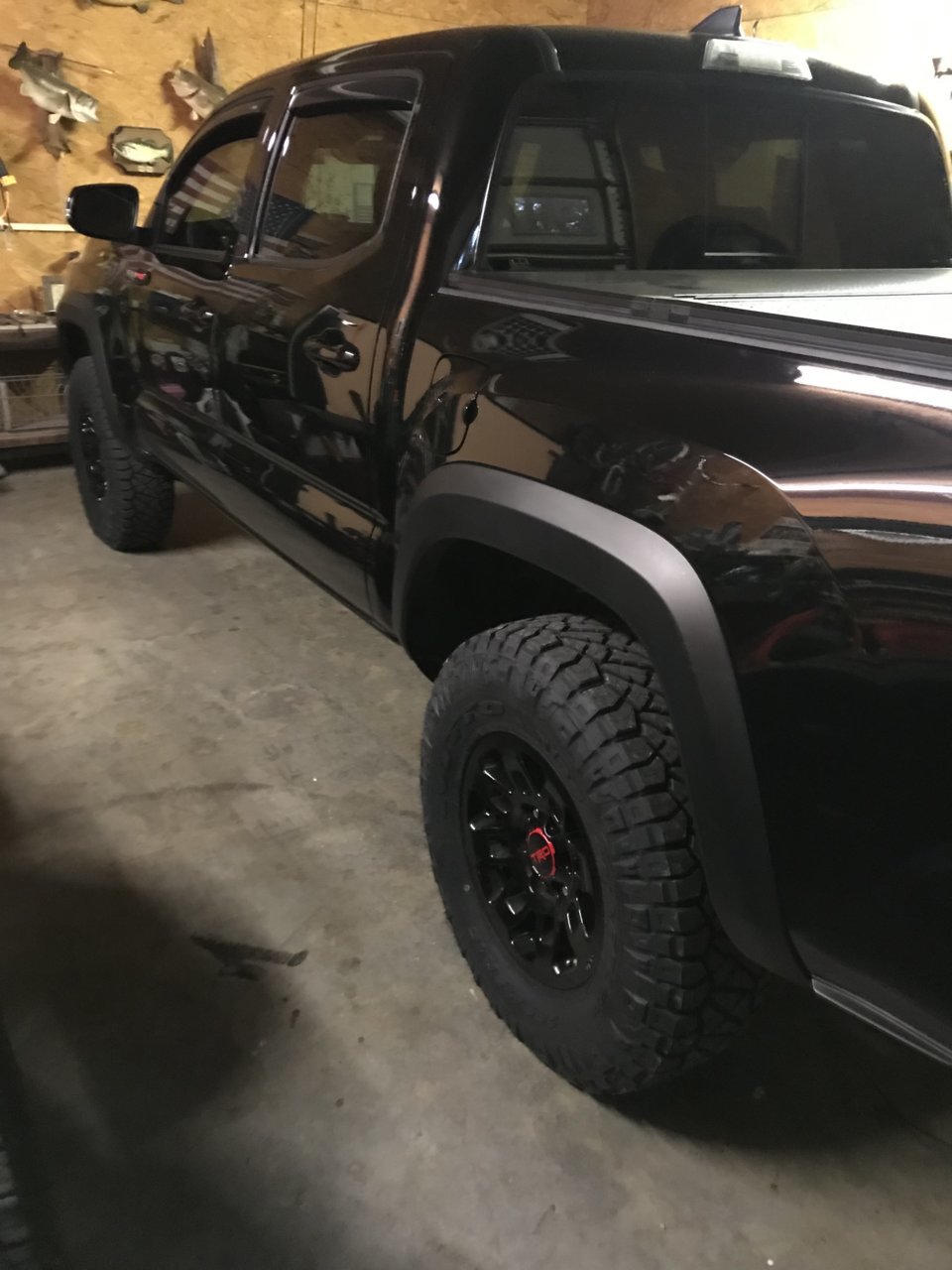

    good size is 265/75/16 keeping the value and fine tuned untouched fox setup IMG_1126.jpg

    Are those ridge grapplers in a 265/75/16? If so what load range and if not what are those?
