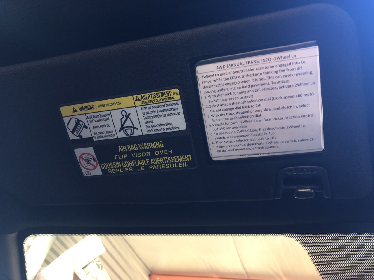

    This mod is a bit involved. Save the PDF as a Word file then reduce the font, or it’ll print the size of the page

    Well. Seems to advanced for me. Can you just email me the file lol
