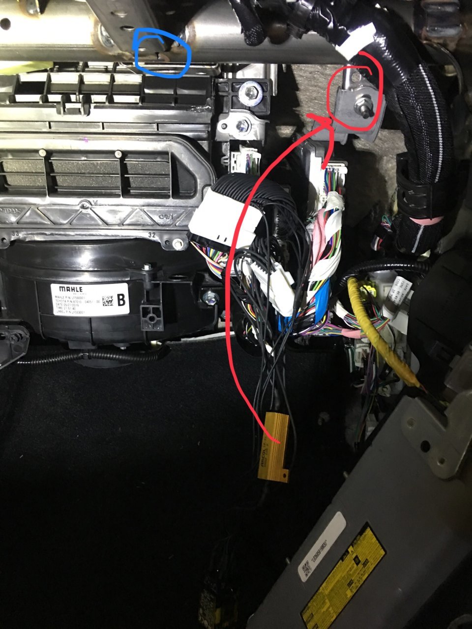

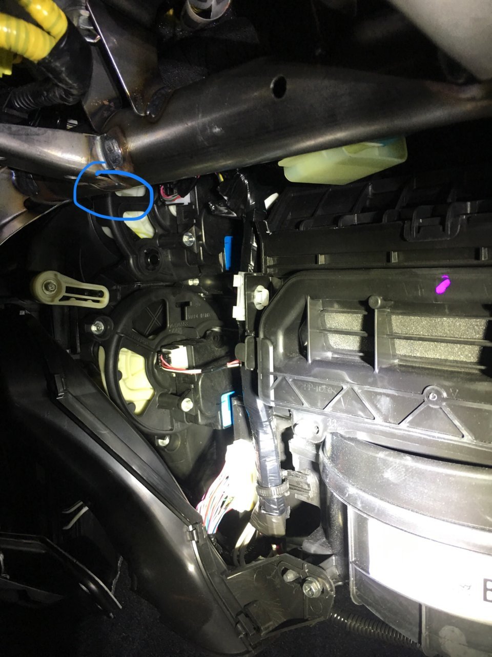

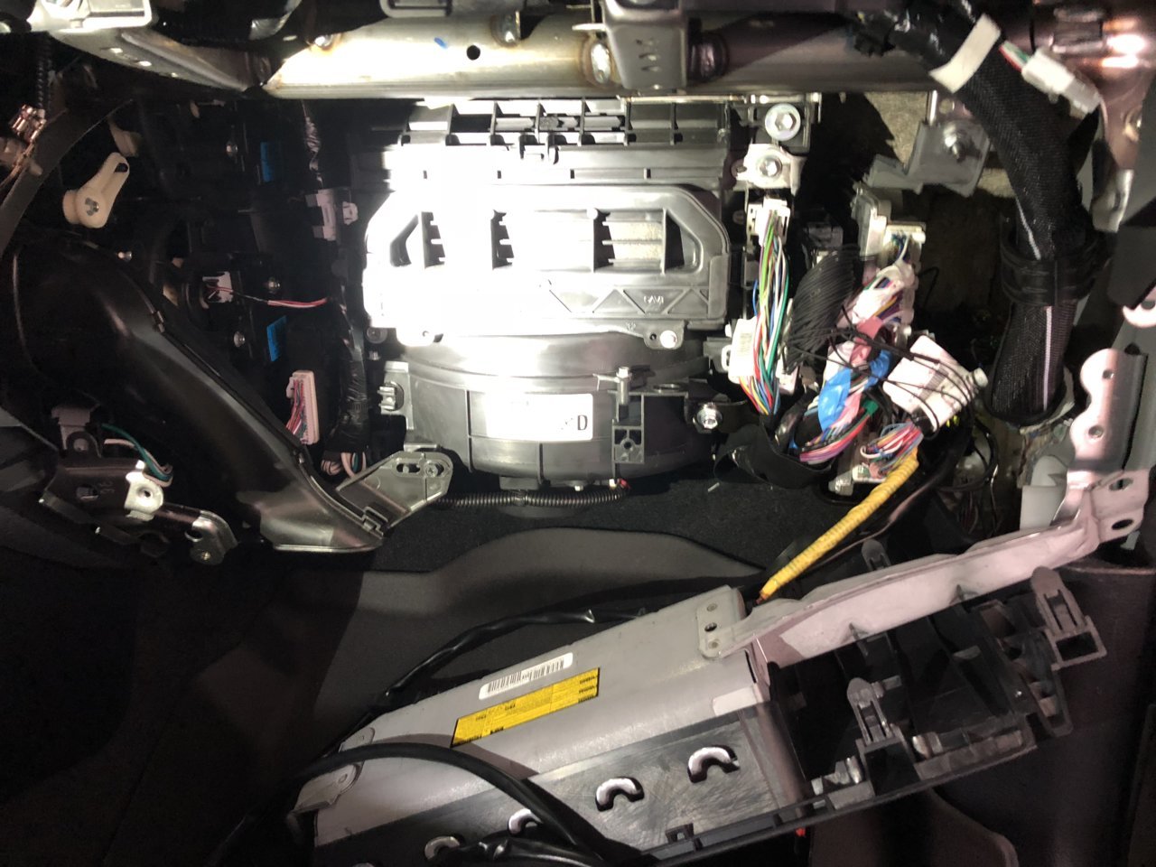

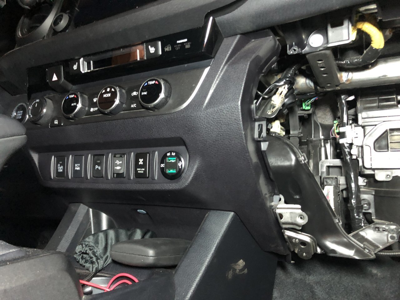

    Got er done! Pretty straightforward following @BigWhiteTRD instructions for passenger side airbag/glovebox removal. I’ll add that I went ahead and just pulled the door sill trim piece and lower kick panel all the way out instead of just popping the top of the kick panel out of the way. They both come all the way out easy.
    I zip tied the resistor to the metal bracket shown here in red...
    And then ran the switch wire along the round metal pipe, with zip ties shown in blue...

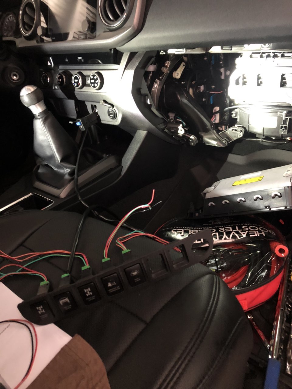

    I used the left-most center panel switch position for the new CH4x4 switch. I drilled a small hole in the blank to pop it out, then fished the 2LOPnP harness switch wire through from the passenger side. No additional dash removal necessary.
    Tested it all out and put her back together. It’s a little eerie to engage 4WD and not actually drive the front wheels.
    Had my wife help me turn the front wheels in real 4x4 and in 2Lo to test - needless to say she did not understand why I was so excited to have “broken” the 4WD in my truck with this “4x4 Trickery”. :D
    Thanks @lapoltba for putting this together! Add a 2019 TRDOR6MT to your successful, happy customer list.

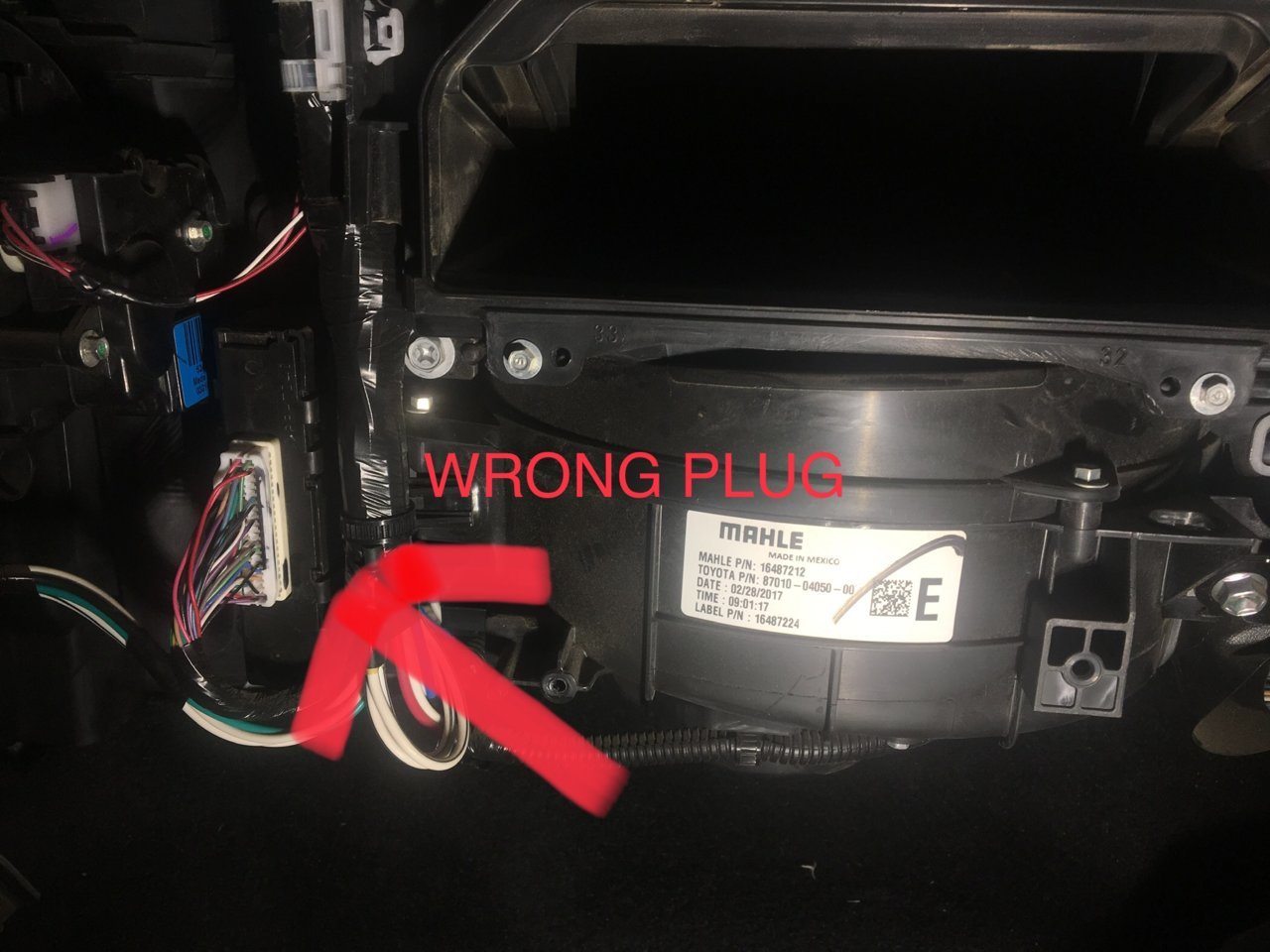

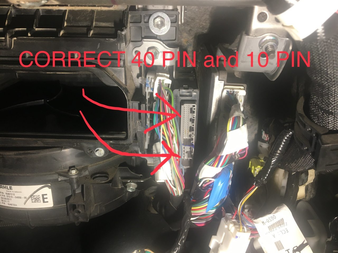

    Disregard the post above.
    I plugged the 40 pin connector into the wrong plug. Don’t plug it into the 40 pin on the left side of the ac blower.
    Both connections are on the right side in the same location on the 4wd ecu.
    2low kit works great now:facepalm:

    I most certainly didn’t do this momentarily, and then also forget to plug that other 40pin connection in after the dash was already back together... :anonymous:
    PS, you can get to that other connector with the dash in 1 piece. ;)

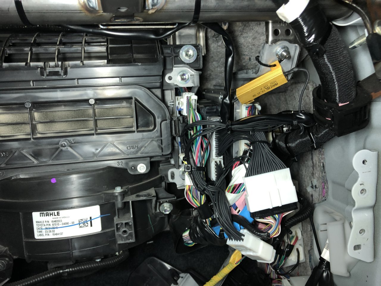

    Done and done! Install was a breeze. Of course, if you can follow directions, it’s even easier. I recommend reading @BigWhiteTRD ’s write up before diving balls deep into this mod. Between gaining access and having working knowledge of what’s going on behind the scene, you’ll be much more prepared.
    Here’s a few pictures I snapped on the install.
