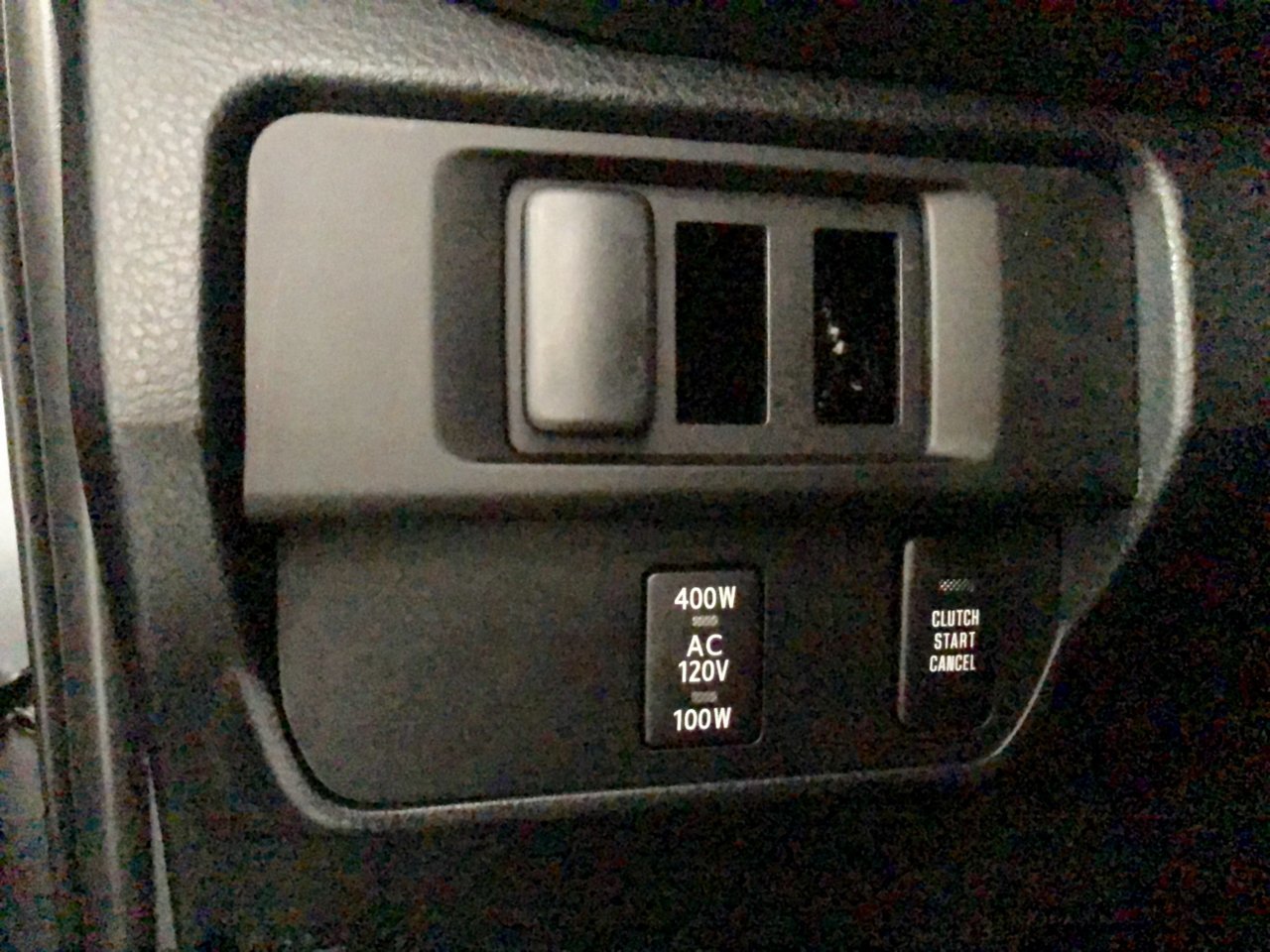

    Damn you guys are picky, I’ve got switches not even hooked up yet

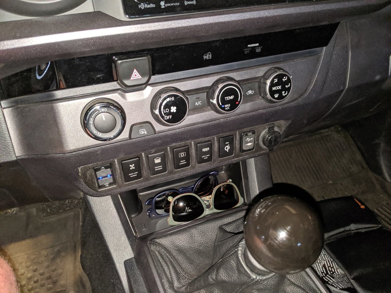

    The garage door opener and rear camera still need wiring up and I don't even have a light bar yet. :rofl::rofl:
    I thought that I might be bothered by the always on 2LM light, but not in the least.

    Three more spots to the left
